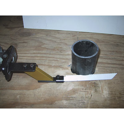

But any way I would use a blade like this.
Its called a Torch Blade and its designed for exactly what you are doing. Getting the special jig would help but if you get the long one not really necessary.
Once off use a nail set to hammer out the rest of the nail from behind.
