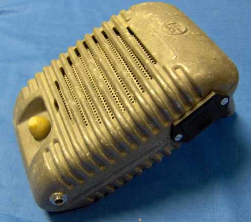

Also a couple amps I build in limited quantities...

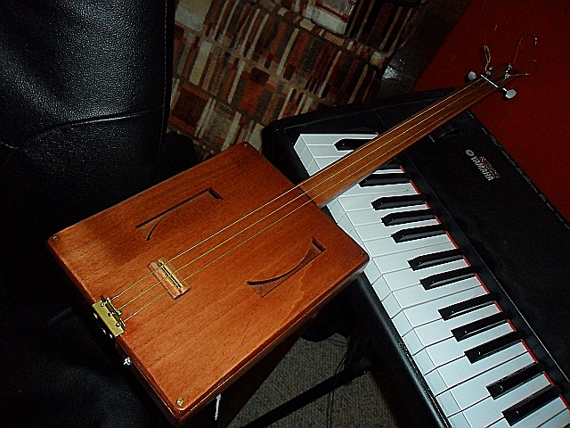

Postby rmclarke » Sat Dec 24, 2011 12:14 am
I guess this should probably be in "Off Topic" but it's a cool thread anyway... :thumbsup:

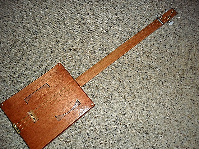

Last summer at one of the Jefferson State gatherings, one of the guys had a strumstick he had built. His craftsmanship was superb and it sounded great I really liked it
and I thought it would make a nice project for the long winter. I started this in October but I'm not finished yet.
I decided to go fretless for this first attempt. And just three strings. It has a piezo pickup, which actually sounds quite 'nasty' (in a good way) through the amp. :thumbsup:
I was going for quick and cheap here and I didn't have a cigar box, so I built a box with leftover trailer building stuff. Works for me.. :)
Used an old, cleaned up cabinet hinge for the string saddle. It only cost me about $20 (mostly for the strings, piezo buzzer, and the tuning pegs, and a couple of bolts)
not bad for a cheap winter project and a lot of fun too.
This place for supplies:
https://www.cbgitty.com/cubecart/
The strings are too high on it right now, and I'm no good at fretless. So I think I'll fret it...like a dulcimer.
And one more thing, these things are kinda like tiny trailers, you're planning the next one before you're finished with the first! :lol:

Postby StPatron » Sat Dec 24, 2011 12:28 am
Beautiful work on the hand-made box, I really like the sound hole design. Gitty's the place for supplies, I order from him too. Yeah, very addicting. I started out thinking I would only build one, I'm working on #'s 13 thru 16 now and still building amps. Cases come next. :lol:

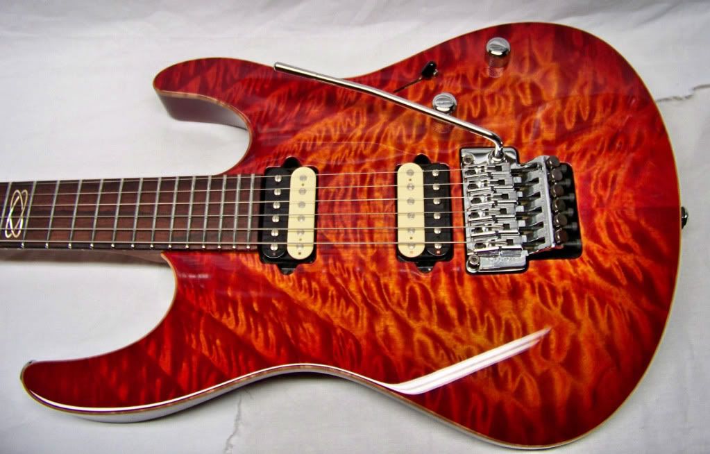

Like Mahogany? My 2008 Suhr Modern LE 8th Anniversary, Mahogany Neck, Mahogany Body, Museum Grade Quilt Top

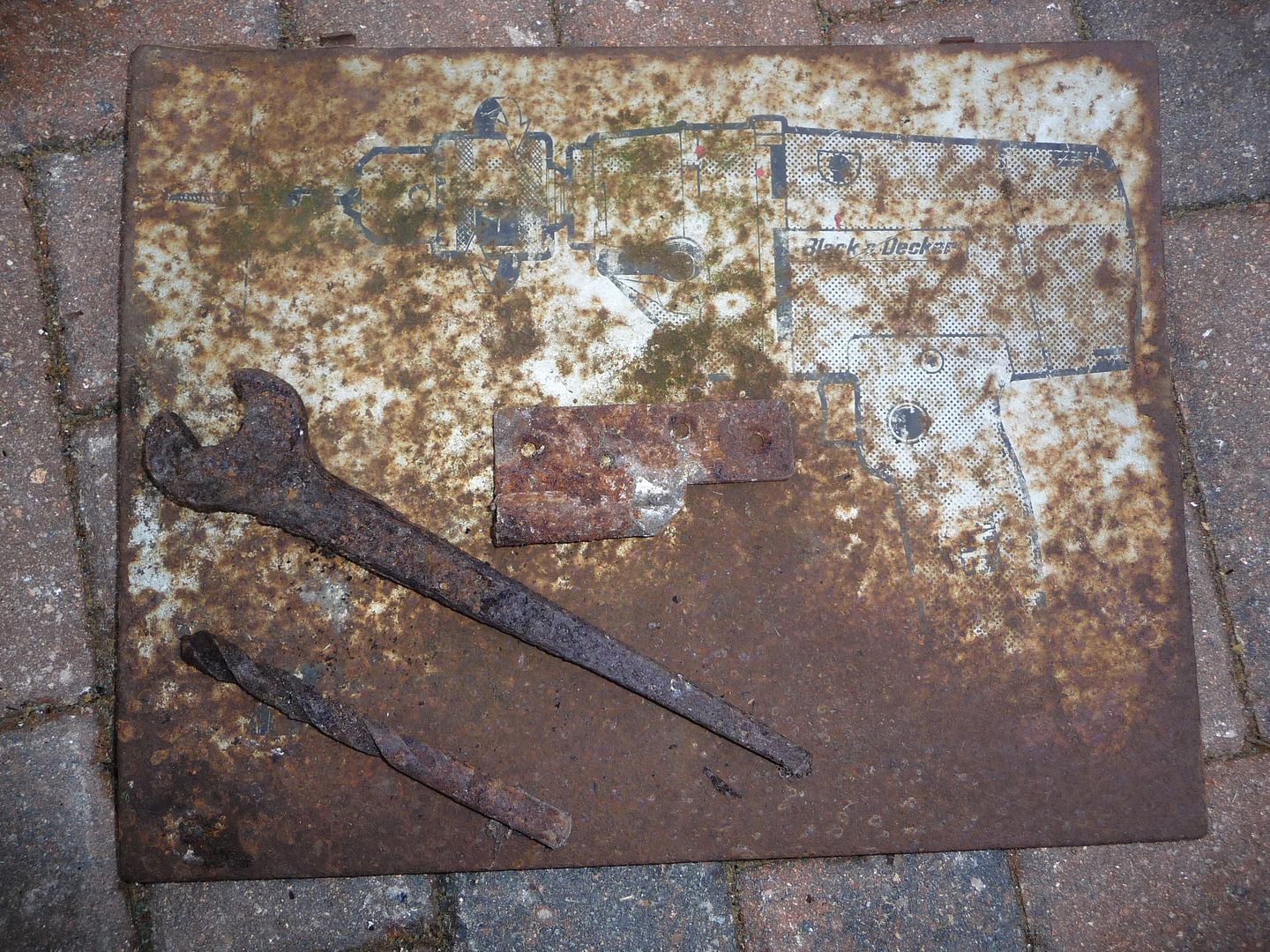

I did however find and old drill box lid, which may become the lid of my next CBG, and a rusty spanner to turn into a percussion tool for the Diddley Bow I want to make (I actually started on it already) and a 10mm drillbit, that has been turned into a punch for the woodwork stuff.
I also found half of a self closing hinge......
Cut it to shape with the grinder and started to clean up the other bits.
