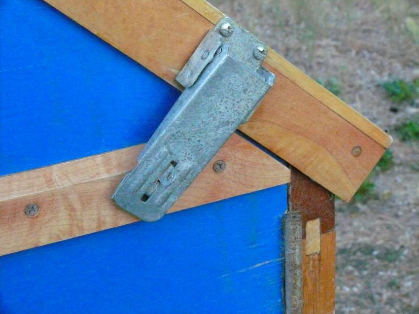

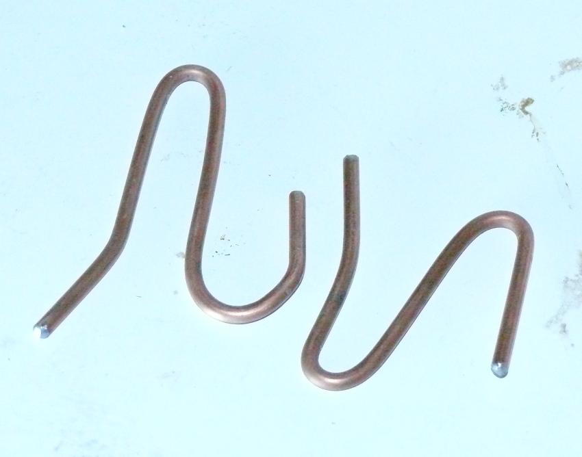

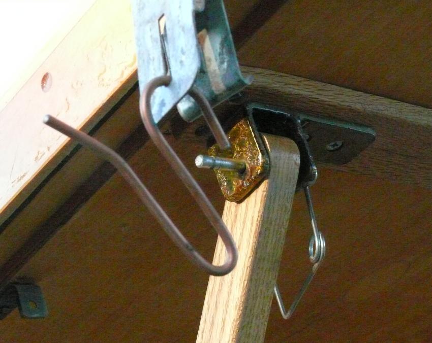

Here is my little cleaver mod I thought up on a trip in May this year.
First there is the hatch latch. Nothing wrong with it but it is where it begins.
Now for what I call. "My squigles" Made of copper coated gas welding rod. No idea what diameter, it is what I usually have around. Use what ever is handy, can be bent and still take what happens in the end.
Open hatch and hook squigles in the latches, both sides if you wish.
And here is the whole point of the squigles.
Haven't really used it yet camping but I think it will be handy and weight almost nothing and little packing space.

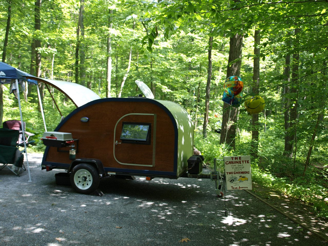

Folks have made nice comments about our portable gas grill that hangs on a rail on the side of our teardrop.

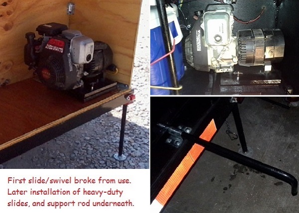

  • I've got two new mods (is it really a mod when the initial build is still underway?) just added. The first was a sliding swivel mount for my generator (eventually to power lights/ac/and recharge batteries). Locks in place both stored and in operating position(s). I also have a lightweight brace to mount under it to further dampen vibrations (already rubber mounted).
    generator-first install, modified.jpg (112.25 KiB) Viewed 561 times
    photo added 7-2-17
  • The second mod was a set of frame mounted stabilizers, made from pipe clamps and 3/4" pipe components. Locks in raised position for travel, then simply drops down to whatever depth needed to stabilize the rear of trailer from tipping or rocking. Clever or not?, I can't say, but done for cheap in the industrial/automotive/what-have-you motif of my build.
  • 95051
  • Note: just noticed a month after building pipe clamp stabilizers (haven't been near it for that long)...the pipe clamps are mounted upside down in this picture; they lock in the up position, not down...oops...rectified that and tested, they will sustain 1200 lbs weight now.

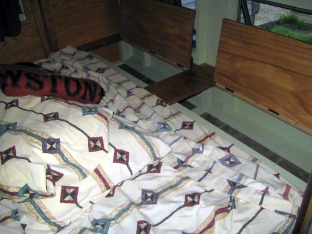

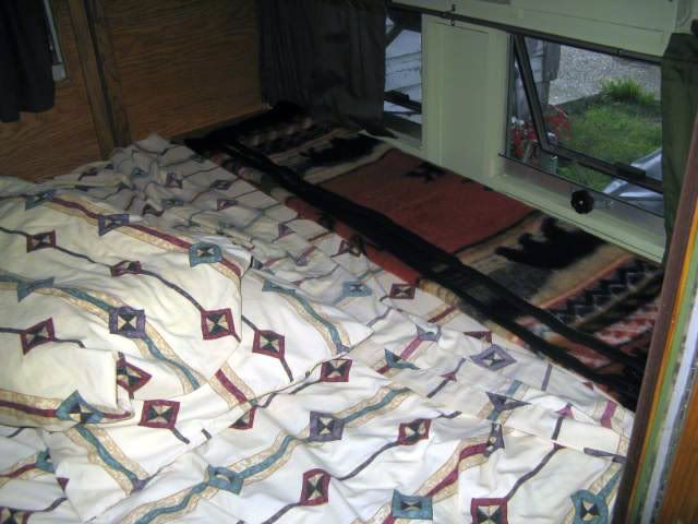

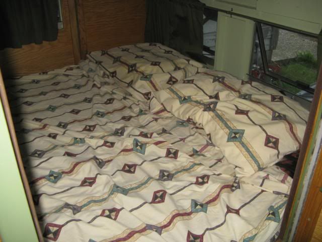

We have been happy so far with my under-head storage mod. My wife and I can fit at least 5 days of summer clothes in it.
