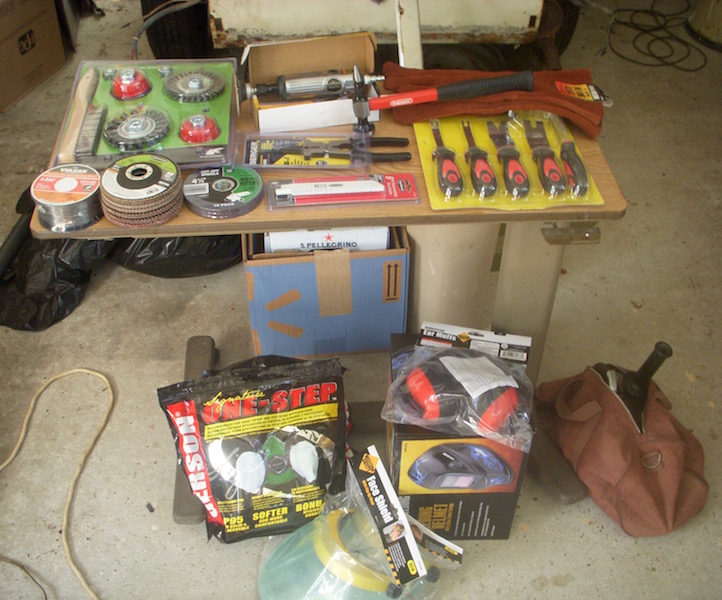

Postby GPW » Sun Oct 13, 2019 5:39 am
We went to HF yesterday and got a few things we’d need … They had everything except the welding machine we specifically went there to buy ( grrrr!!! ) So I told them , I’m paying for it now , and at the sale price , and call me when it gets in ( next truck ) ... They agreed :o … And while there I picked up a few things on Sale and a few things that weren't … All things I “needed” … We’re ready …. almost …
And while I was out I VOTED !!! ;)
