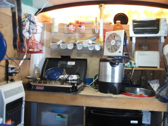

1. The front and a little of the heater on the left wall.
The 40 cup coffee cup /Hot water tank and sunken sink and Convection Oven and Fridge and soon to be gone blue flame heater and stove I might even have room now for the microwave.

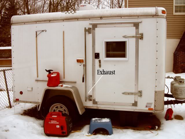

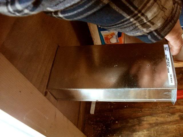

2. The spot where the exhaust is going to exit the trailer.

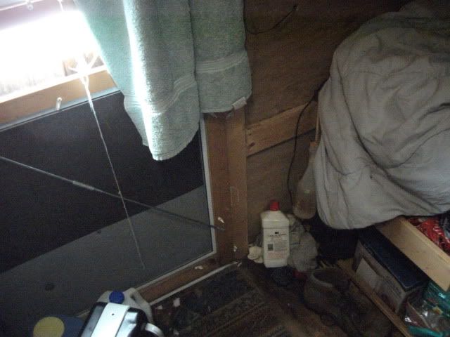

3. The spot from inside where the furnace is going to be inside running parallel to the bed side facing away from the wall. The cabinet will be removed to a new spot. I know that spot is not going to interfear with me crawling into bed.

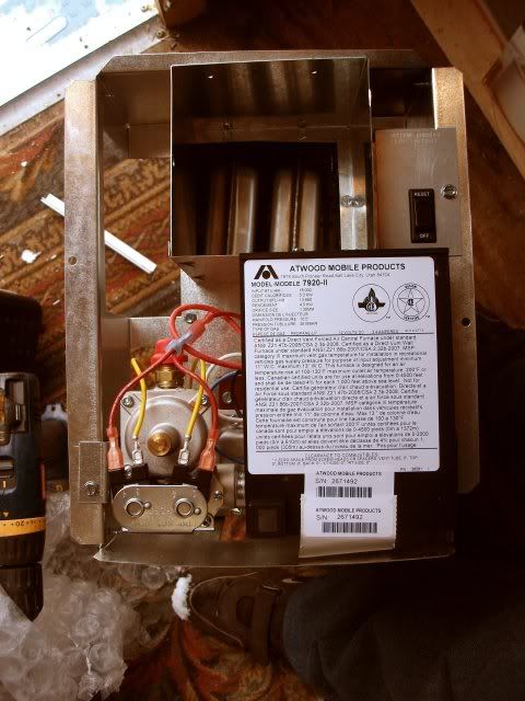

Here is the furnace and parts in photos:

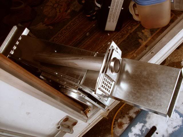

Above: The pipe on top goes inside the extending vent as a intake from outside air. The round exhaust pipe goes inside the intake vent. You'll see soon enough. Doesn't make much sense that exhaust would be vented out the same location as the intake air. Would not the exhaust be sucked in by the same air going out? But this seems to work so on we go. This is the top. The extensions can be cut down. It is going just behind the swing bar to the left. Under neath it will just miss the floor brace for the propane supply pipe.
Above: Looking in front of the furnace. This will be covered up as the front face vent will send heat through this here. This furnace is going to put out more then I expected. Just look at the heat exchangers and located in the center of the trailer all nooks and crannies will get heated.

Above: The outlet side. You can see where the round exhaust pipe connects to.
