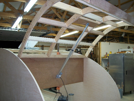

Postby David S » Sat Jun 04, 2011 9:02 pm
Here is mine.A 12volt linear actuator.Image

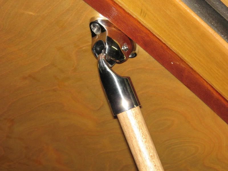

I use 2 poles that swivel and attach to the galley hatch with broom holder brackets.
Here is a closeup of the brackets. They are marine Stainless Steel but were the only thing I could find that allowed the poles to go in both directions.
West marine was where I got them, but I have since found a cheaper supplier. I will have to dig for it. If anyone wants it just post and I'll find it.

Postby Woodbutcher » Tue Jun 07, 2011 12:50 pm
No I don't have to remove the poles to close the hatch, Slow. I just swivel them up and clip them into the broom handle brackets that are in the first picture.
If you come to Minden you can see them in person. :thumbsup:

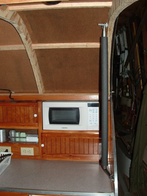

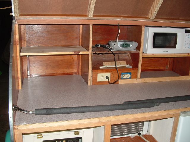

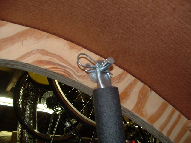

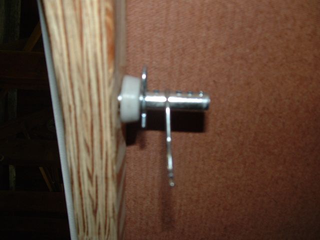

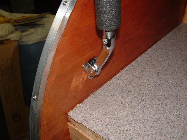

Postby Joamon » Tue Jun 07, 2011 5:47 pm
I would have loved to have hydraulic but it didn't happen. I borrowed a few ideas from here. pics to follow.
The bottom hinged piece is a door stop turned upside down. Then there is electrical conduit. The top is flattened out with a hole drilled in it.
There is a pin through the hatch with clips in it to hold in the up position.
I have pipe insulation around the conduit for looks and to keep it from boucing around in the down position.
