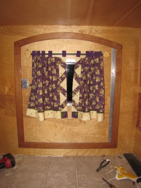

I did curtins. I used a simple dowel. I found the birdhouse ornaments on a fluke at a craft store I drilled a hole in he sides and stuck in the dowel . One side is glued and he other side not so that I can remove the curtains. I mounted them with a metal interlocking finger thing I found in the mark down barrel at the hardware store that was perfect. it fits almost flat to the wall and to the back of the bird houses. It interlocks like the old "here is the house here is the steeple, open the doors and heres all the people". Actually it is more like how you twist your hand together to be able to wiggle your middle finger on either side. If you don't remember that, then I am too old. Too bad I don't have a picture.

Debbie and Randy - Are your curtains held to the rod by plastic hangers or are those tabs of fabric?

They are fabric tabs. They slide very easily

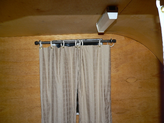

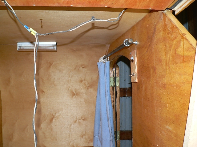

Postby Wolffarmer » Sun Mar 11, 2012 4:25 pm
Hear is my blind set up
The curtain rod is black 1/2 inch water pipe and the holders is 3/8 eye bolt that goes through the wall and on the outside is now a stainless steel cap nut. I have one on each side ( one door on the right side ). The reason I made it this way is so they are also strong enough to be assist bars. Or in my case "Fat ass assist bars"
The curtains themselves are just pillow cases that I have put 3/8 grommets in so I can use shower curtain rings. Need to figure out how to use my sewing machine some day.
