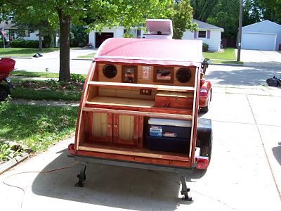

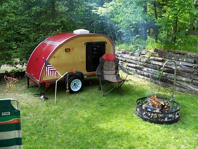

Postby wingrydr57 » Mon Jun 11, 2012 6:32 pm
Another couple pics ;o)
galley door before skinned
first camping trip

Postby indycamper » Mon Jun 11, 2012 6:38 pm
:applause: BEAUTIFUL!
And thanks for the captions on the pix. Until I found the one on the galley, I thought you had invented a new type of hatch cover - one that retracted! :lol: But given the talent I see on here, someone probably already has and I just haven't found it yet.

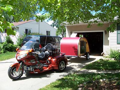

Postby Oldragbaggers » Mon Jun 11, 2012 6:51 pm
Very very nice. What does it weigh? Is your roof just skinned with vinyl? How thick are your walls? Just wondering how you kept the weight low enough to pull it with a bike. Do you have trailer brakes?
Sorry about all the questions, but inquiring minds want to know....
Life is sooooo good.........
Sail...camp....bike...repeat
Becky
Oldragbaggers
Posts: 1842
Images: 331
Location: Essex, MD
Re: finnished my teardrop
Postby wingrydr57 » Mon Jun 11, 2012 7:14 pm
Oldragbaggers wrote:Very very nice. What does it weigh? Is your roof just skinned with vinyl? How thick are your walls? Just wondering how you kept the weight low enough to pull it with a bike. Do you have trailer brakes?
it comes in at 525 lbs. The roof has 1/8 inch masonite on it first then aluminum printing plates then the marine vinyl over that. The printing plates are pretty thin but will protect the masonite if the vinyl gets a cut etc.The walls are 1/2 inch birch ply with 8 coats of marine polyurethane. Cabinets are all pine stained and gloss varnish. No I dont have trailer brakes but the brakes on my trike are from a honda crv , the trike is 61 inches wide so it has a nice wide stance for good handling and it has independent suspension with a rollbar.The goldwing gl1800 also has a 6 cyl motor also. 8)

Postby BillZ » Tue Jun 12, 2012 6:05 am
Thanks for the pics! :applause: :applause: :thumbsup:
That's the best of both worlds. Riding out in the open with the wind in your face and a comfy place to sleep at night!
with 6 cyl and no body weight, I bet your trike tows more than most small cars. 525 lbs should be a breeze.
