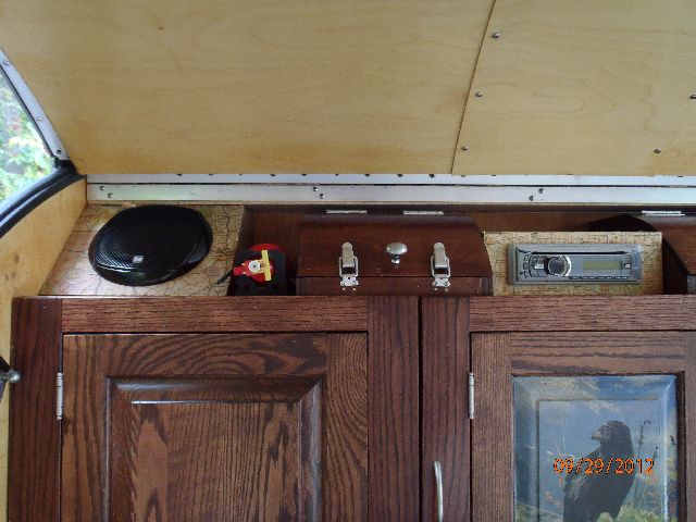

I made a holster for mine. It fits into the shelf so that it won't bounce around in transit, it's removable so we can use it in another camper, and it holds the extinguisher at an easy position to grab and shoot if needed. Plus it made a perfect place to stick my clock.
