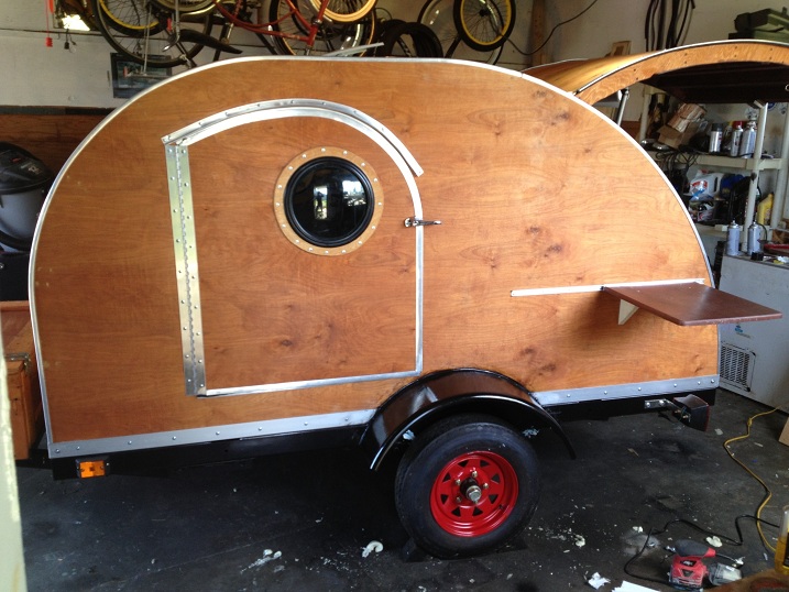

Postby Melven » Wed Apr 24, 2013 8:42 pm
This is what I am working with.
Melven
Posts: 140
Joined: Wed Jun 13, 2012 9:47 am

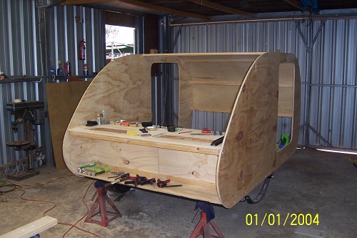

Postby Roo Dog » Wed Apr 24, 2013 9:07 pm
Melven,
We used diamond or checker plate as per Lgboro.
Looks okay, to us anyway.
RD

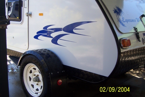

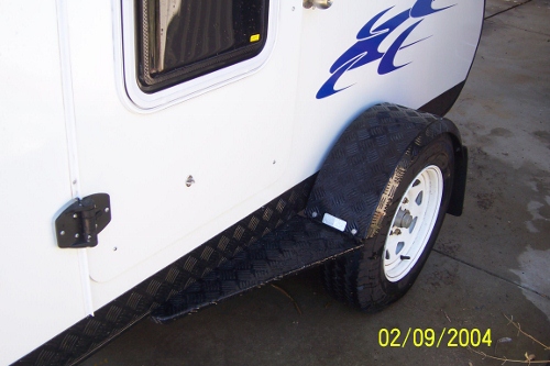

Postby Roo Dog » Wed Apr 24, 2013 9:54 pm
Melven.
It is a standard plywood Tear under the skin.
It was built by my SIL and myself. I am a retired aircraft mechanic and the SIL is a sheet metal fabricator/welder.
RD

Postby Melven » Wed Apr 24, 2013 11:54 pm
DMcCam wrote:Here's how my fenders look with the VW welting.
Cheers,
Dave
Melven
