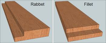

Postby halfdome, Danny » Sun Oct 13, 2013 11:05 am
The method used in the second video is way too labor intensive and having the grain going in different directions will show, even when painted.
Remember, you'll be looking at the ceiling while laying in bed, so make it as nice as possible.
I use my router with a wood fence clamped to the base and route a 1/4" deep rabbit along the 3/4" thick roof profile to the depth of the spars and ceiling profile.
After the walls and bulkheads are attached to the floor I drop the pre finished 1/8" Baltic Birch ceiling down on the lightly glued 1/4" rabbit edge and staple it down.
I then glue & install the roof spars.
Where there is a joint on a spar I use lath screws to temporarily pull it up tight.
I don't have a seam going the length of the ceiling as shown in the video.
After the screws are removed I put a 1/4" x 3/4" piece of matching trim over that joint and one in the same spot at the other end to give it some visual balance.
I use prop sticks to hold the rest of the roof while the glue dries to the spars.
This produces a nice looking ceiling even where the walls and the ceiling meet.
:D Danny

Postby halfdome, Danny » Sun Oct 13, 2013 2:06 pm
kd5edj63 wrote:
halfdome, Danny wrote:I use my router with a wood fence clamped to the base and route a 1/4" deep rabbit along the 3/4" thick roof profile to the depth of the spars and ceiling profile.
:D Danny
can you explain that better. Whats a rabbit and what kind of stapler do you use
Don't know how to explain it any simpler.
This is what a rabbet looks like on the left.
I use a [Pneumatic 1/4" narrow crown stapler.
:D Danny

Postby kd5edj63 » Sun Oct 13, 2013 2:35 pm
I guess I would need to see the side wall with the rabbet cut into it to make any sense of it. I'll look into an air stapler. Thanks
