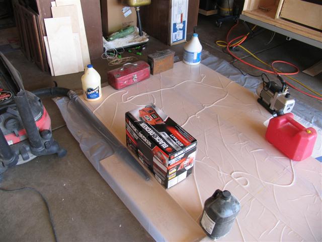

I used cord. I looped the cord back and forth across the top skin, from the far end back into the vacuum hose. Seemed to work well enough. The hard part was getting the seams of the bag taped good enough for a deep vacuum. I ended up using a laminate roller to really stick the tape down.
Bruce's Vacuum Bag

That's what I thought too but that's not what happens. The shop vac motor is actually unloaded when the vacuum is highest, drawing less current than when it sucking a lot of air. Mine runs surprisingly cool and heat is not the issue I thought it would be. I have a purpose built vacuum pump and ditched it in favor of the shop vac, the shop vac worked much better. The higher volume of the shop vac compensated for all the little leaks in the taped seams better. I also used titebond II glue, which has a set time of 1/2 hour, so I only clamped mine for an hour or two.
