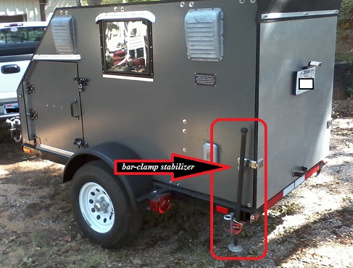

However, if I had wanted to level the trailer (if situated on a flat pad at a campsite), I would've attached the tongue jack, lowered the nose about an inch, then release the "bar-clamp stabilizers" (which support up to 600lbs each) on the rear corners.
    BAR-CLAMP STABILIZER
    9678696778

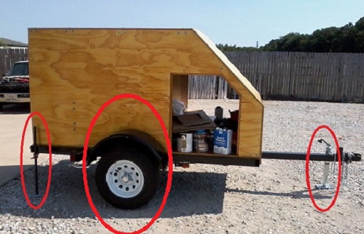

Their design is such that they slide down to rest the feet on the ground, and lock in place. Then I return to the tongue jack, and raise the nose until the bubble-level indicates that it is level (usually, about the inch I had lowered it). At that point, the trailer is supported at 5 points: 2(rear-stabilizers), 2(sides-tires), 1(front-jack).
STABILIZERS rear/TIRES middle/JACK front

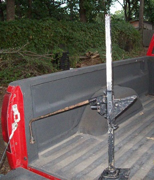

I have not had to use this system on un-level ground, yet, but I have tested it. I use the same procedure (the "inch" may be in multiples) for fore and aft levelling, but for side to side, or four corner levelling, I carry an old bumper jack from my Chevelle (shown in my avatar),
CHEVELLE JACK (re-painted since photo)
which I use to raise the sides or rear up to 18" over normal height. Once level, I can drop the stabilizers down (up to 30" of variable adjustment) to the ground. I carry 4 barbell weights along, which I can use as additional base pads for the jack or stabilizers (if not, then to weigh down the canopy, if I choose). If more levelling or bracing material is needed (doubtful, since I'm not off-roading), I have additional treated 2"x*8 lumber (used as partitions in the bed of the truck), which can easily be temporarily pressed into service. I figured that I needed to cover all the bases, just in case, so that's why the stabilizers are so long.
