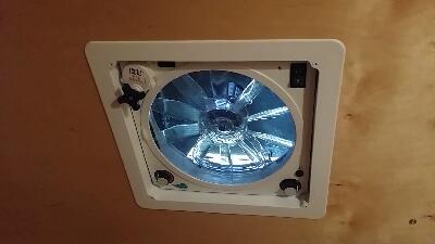

Postby SPLAT » Sun Feb 28, 2016 9:42 pm
Installed, works great... Took a little modification because the flanges were different :thumbsup:

Postby jss06 » Mon Feb 29, 2016 7:53 pm
SPLAT wrote:Installed, works great... Took a little modification because the flanges were different
Awsome. Glad it worked out for you.
