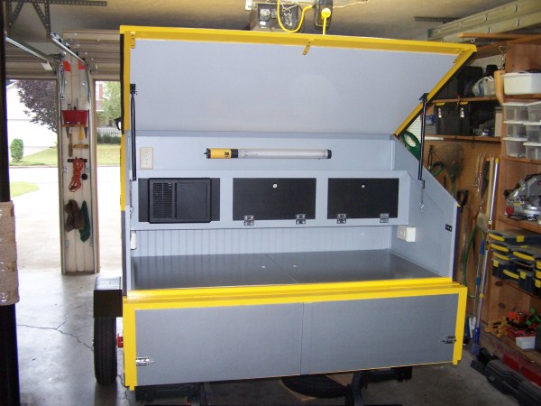

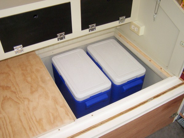

My galley countertop is in two pieces that slide over each other with storage beneath. That's where I keep the coolers, propane stove, coffee pot, and other camping gear. After I take the coolers out, they stay outside or store in the TV at night.
View of galley while still under construction.
View of completed galley.
