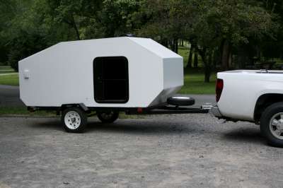

On my 1rst build, I used white epoxy paint. It held up well until it sat uncovered outside for a few years.
