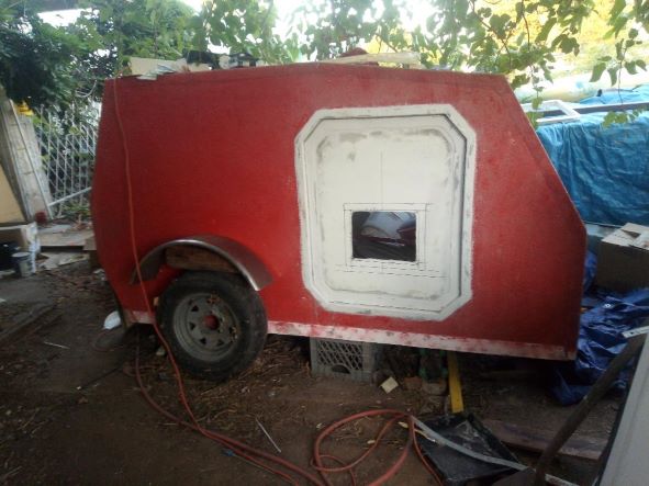

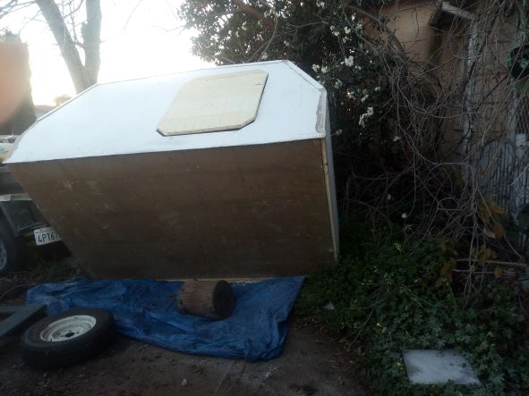

if you're going to use fiberglass. Why would you use wood what a waste. you can build a indestructible , insulated trailer. If you drop it of a cliff you go to walmart to fix . Beware of dam liars about ploy resin and home depo foam it is the easy way to build you cannot mess up it like a Lego . Pods run under 200 lbs. for 5 by 5 by 10 there is no better way to build a forever trailer. Family trust owns a few RV repair shops is also involved in heavy ballistic components.
