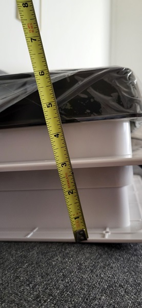

Has anyone had this issue? I bought a fan vent through amazon and the description says that its recommended roof thickness: 37-85mm. When I received it and took it out of the box, I looked at the gap between the inside trim and the fan, and its too much. Mind you, this is the way it came in the box. What I mean by the "inside trim" is the part that goes inside the cabin and up into the fan housing, its the part that you screw into your ceiling. Well, I took out the fan out of the box to see if there was anything blocking the inside, nope. :x It literally sits on the inside part of the fan at 2 3/4 inches or 69.85 mm as its shortest. The description says that its recommended for 37mm -85mm roof thickness. My roof/ceiling thickness is 1 3/4 inches. Have any of you encountered this problem? did you simply cut off the inside trim to fit your ceiling? Its plastic and I don't know how i'm going to trim all 4 edges so that it doesn't crack. My wife and I tried flipping it over and that will work, BUT the trim part that goes inside the housing is now facing down towards the cabin floor. Obviously if we left it this way we would hit our heads on it since its sticking out. I've posted the link from amazon. I could return it and get another one but I wanted to know what you guys thought. It seems like a great fan and I wouldn't want to return it, but if I have to, I will.

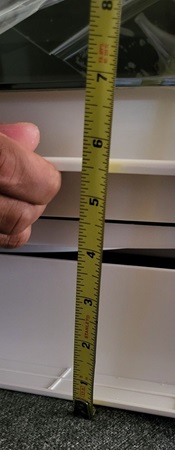

I forgot to attach a couple of pictures of the thickness.
shortest gap, its not 37mm
biggest gap, give or take
