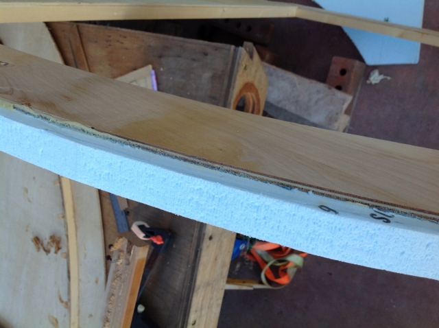

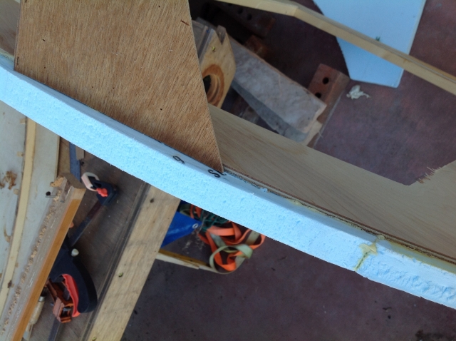

Postby RogHodge » Wed Jun 05, 2013 7:14 pm
Or maybe it is because you all hate me and I should just throw my lollipop in the sand and run home and cry :cry:
So here we have the interior wall, don't judge me by the mess, or water damage, or etc or etc.
And the close up of the wall / foam joint
And the proposed placement of the roof, which would be glued and stapled, and then would then be covered by foam
In other news, thank you for this forum. It was improved tremendously since I lost contact. Uploading pics is a breeze and as always the information is wonderful. Mike, I know you probably here this a lot but you are greatly appreciated.
Roger

Postby 48Rob » Wed Jun 05, 2013 7:40 pm
Roger,
When you ask a very specific technical question like that, it leaves those of us who are not experts, waiting to see what the "experts" say... :thinking:
I could offer an opinion, but since I'm not an engineer, I hesitate...
Well, okay, I'll offer my opinion anyway...
I would want some sort of blocking in the corner between the two thin sheets, to strengthen the corner.
As for spars/no spars, the curve is very strong, to a point.
The structure will be self supporting until the span, from side to side, becomes too great.
I just don't know how to calculate that distance using math.
Just guessing, I'd say about a three foot span would be the maximum I'd trust.
Rob

Postby mezmo » Wed Jun 05, 2013 10:10 pm
Hi Roger,
Don't forget to let a bit of time to pass to allow your post to
have some exposure. I don't think a day is enough time to
get enough exposure for multiple responses to your query.
Plus, as Mike said, it may have been/be hard for others to
visualize your question just by written description. Your later
posted pic really brings your question out into the open.
Your construction method is close to one of the building approaches
I've been thinking of - using the plywood boat building method of
stitch-n-glue for the interior walls, then covering those in foam.
[I like natural birch paneling and want that as the interior finish.]
What you are asking about is very close to that. The one caveat
or consideration I'd have is, if the glued plywood continuous butt
joint between the wall panel and roof panel would be strong enough
to hold them together. I don't know what kind of glue you're using,
but the stitch-n-glue method [from what I've read about it] uses
thickened epoxy as the glue and makes a continuous fillet/cove of
that between the joining plywood panels that in effect makes them
into one unit. [Edit: 6-7-13, Forgot to mention they also fiberglass
tape and epoxy all the continuous joins to achieve the 'one unit'
effect] If you're not gluing with epoxy, maybe you could glue
some kind of extra, thin pieces of wood or molding that could follow
the curving continuous butt joint at the interior panel's join that'd
act similar to the thickened epoxy fillet. The curve should help give
the plywood width span strength. Just Google 'stitch-n-glue' or that
along with 'plywood boat building' and you should get multiple search
responses that you could check out to further inform you more on that.
They do have small flat-bottomed punt-type designs that use some
epoxied-in spar-like bottom stiffeners, as well as other designs that
rely on the 'intersecting curves or compound curves' of the boat's
shape as stiffeners.
One other question I'd have is, how are you going to bend the 1/4 inch
plywood along the curve of the sidewalls ? Kerfing the back of it some ?
As it seems that the 1/4 inch ply sometimes needs persuasion to get into
the curve one wants, you need to come up with a method to do so. Maybe
using a few spars [1x on edge] on the back/outside surface of the interior
1/4 inch plywood roof panel would give you something to hold on to
while trying to curve the roof panel to the sides, and in the meanwhile
they'd add some additional hidden strength for the width span of the roof.
[A couple builders on the forum here have done that, both for hidden
(within the roof) and exposed (visible under the roof/ceiling surface)
spars.
I'm not an engineer either, but then if the world waited for only engineers
to try out things, there'd be extremely slow progress in everything. An
educated guess/approach, or even some WAG-ing along that vein, by anyone,
often results in as many successes and advancements as failed attempts,
in my view.
Just some thoughts on your topic for your consideration...
Norm/mezmo
