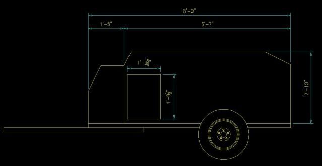

Postby BigE » Tue Mar 24, 2009 8:34 am
Ok so here is what I've got so far.
As you might see, this design is based off of Joann's awesome "Desert Dawg" design.
Some modifications though. It has to be tall enough to squeeze in a bunk for two children to crawl up on. Also, there is no need for a hatch as we've got other plans for the galley area.
Any ideas and thoughts for the dimensions would be greatly appreciated.

Postby stomperxj » Tue Mar 24, 2009 10:16 am
The way you have it drawn it looks a little short if you're only going 8' long. Doesnt leave much room for a bunk. What are the dimensions of the tongue box?

Postby stomperxj » Tue Mar 24, 2009 10:27 am
Alright so i whipped it up in CAD really quick. You should go get some graph paper and try to draw it to scale. The proportions are a little off. I traced right over the top of your picture and here are your dimensions:
2'-10" is a little short for the interior height. Those tires are 24" tall with 14" wheels

Postby BigE » Tue Mar 24, 2009 12:20 pm
Thanks, I was needing the help with the dimensions the most. That front part isn't a tongue box, it's all apart of the cabin. How high would you suggest in order to allow a bunk?

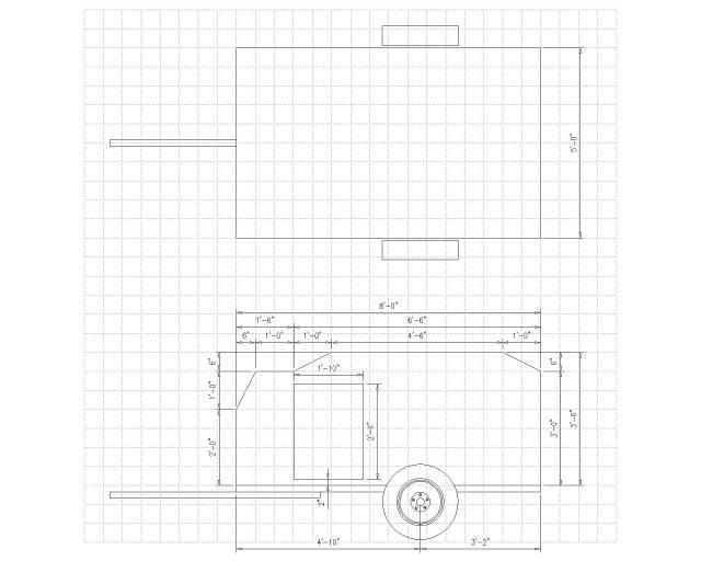

Postby stomperxj » Tue Mar 24, 2009 2:35 pm
Here's my take on that shape. I can send you a PDF you can print out if you want. Thats a 6" grid i put on it for you...
Let me know-

Postby BigE » Tue Mar 24, 2009 2:41 pm
That is awesome! Thank you for doing that. I would love it in pdf form.

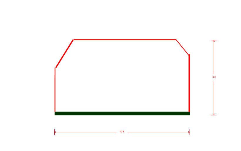

Postby BigE » Tue Mar 24, 2009 10:39 pm
Thanks Miriam! I went out a minute ago and got some graph paper and worked some things up. My end result was 5 high, 5 wide and 10 long. I wasn't really going for looks as much as I was trying to cut some of the wind drag. :lol:

Postby BigE » Tue Mar 24, 2009 11:05 pm
Ok, I think I've got my graphics program setup to get me a more proportional view of things.
