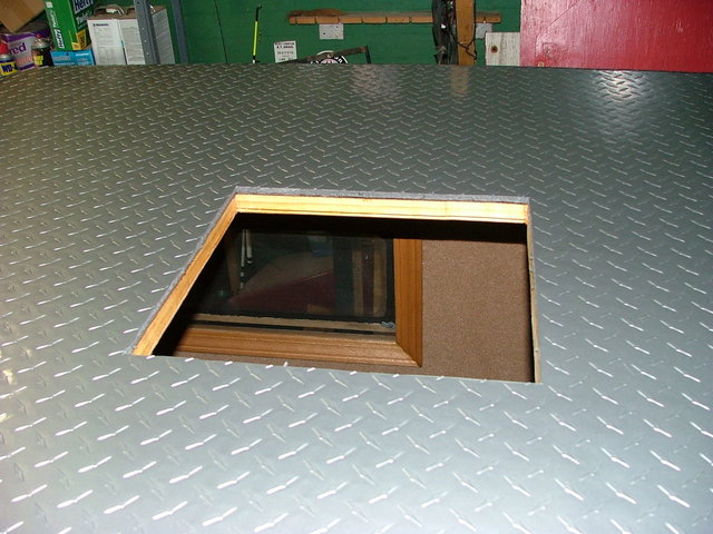

Postby WarPony » Tue Sep 11, 2007 7:00 pm

Postby deputydogrick » Tue Sep 11, 2007 8:04 pm
war pony,
Now you're teasing me, where did you get it and what is it called?
Rick 8)

Postby Chaotica » Tue Sep 11, 2007 8:20 pm
deputydogrick wrote:war pony,
Rick 8)
It's called diamond plate vinyl and I believe the link that teardropsleeper posted has it.

Postby WarPony » Tue Sep 11, 2007 8:43 pm
Rick 8)
It is called vinyl diamond plate, as Chaotica said and I picked mine up at my local car interior guy.
