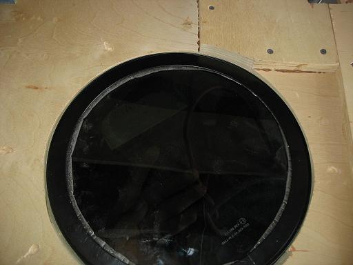

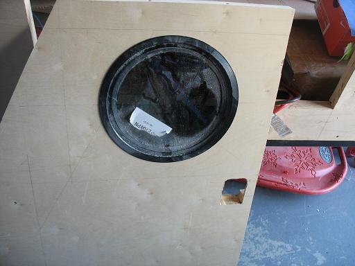

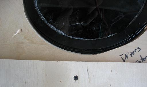

Postby Forrest747 » Tue Jun 08, 2010 11:19 pm
Here are some pics i took. I am going to try to mix the epoxy with some wood flour or sawdust and see if i can close that gap in some. Also has anyone attached the window by screwing through the outside trim piece. with buytl tape behind it. I am afraid to drill through the side and breaking the glass. The windows came out of a van. Image Image Image

Postby Micro469 » Wed Jun 09, 2010 11:06 pm
I see it looks fine on the outside. The inside shows the gaps. But it also looks as if you dont have the inside skin on yet. Is that right? If so, you don't have a problem. Just make sure you cut the hole in the inside skin the right size, and whatever is inside the door is completly hidden.
John
Micro469
Posts: 3185
Images: 382
Postby Forrest747 » Thu Jun 10, 2010 12:37 am
Micro you would be correct i have not skinned the inside yet. THe plan is to cut the hole inside and trim it out. it the attaching the window to the door i am having an issue with. Did not come with a clamp ring or anything like that. it was designed to just pop in the van from what i can tell and i havent been able to find that set up. So drilling holes and using screws or bolts to attach is the way i am going. this is fun to figure out.
