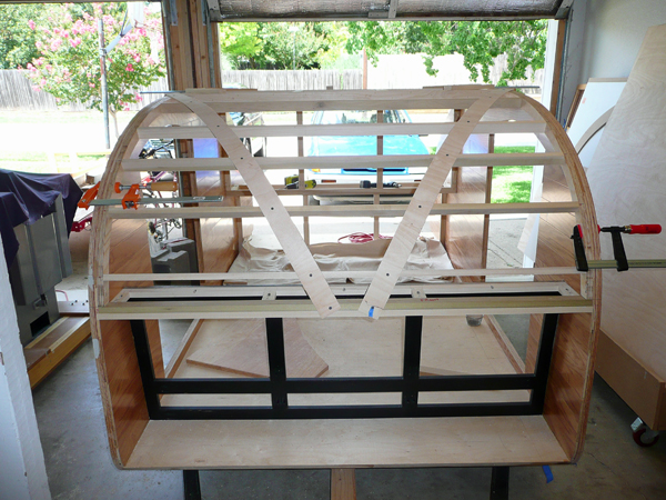

I went down a different path. I used 1-1/2" deep, 3/4" ply "ribs". The ribs were temporarily held in place and spars were attached to the ribs via pocket screws. I added temporary straps to keep the framing from racking and then removed the assembly to the bench to glue and fasten the plywood and attach the hull liner with spray adhesive. Then I placed the assembly back in place. The ribs are glued to the sidewall with PL premium and are fastened using deck screws. At each rib, I used a deck screw from the outside of the sidewall into the sidewall, rib and spar.
It looks awkward but I found benefits to me for doing it this way were:
1. I made the assembly removable so I could add plywood skins and hull liner on the bench rather than working overhead.
2. The double thickness of the sidewall gives more "meat" for the screws used to hold the roof / sidewall trim.

Postby RunnerDuck » Mon Oct 12, 2015 9:30 am
Thanks Tom for the concept and pictures.
Unfortunately I've got very limited space and will probably go with the "single dado" method.

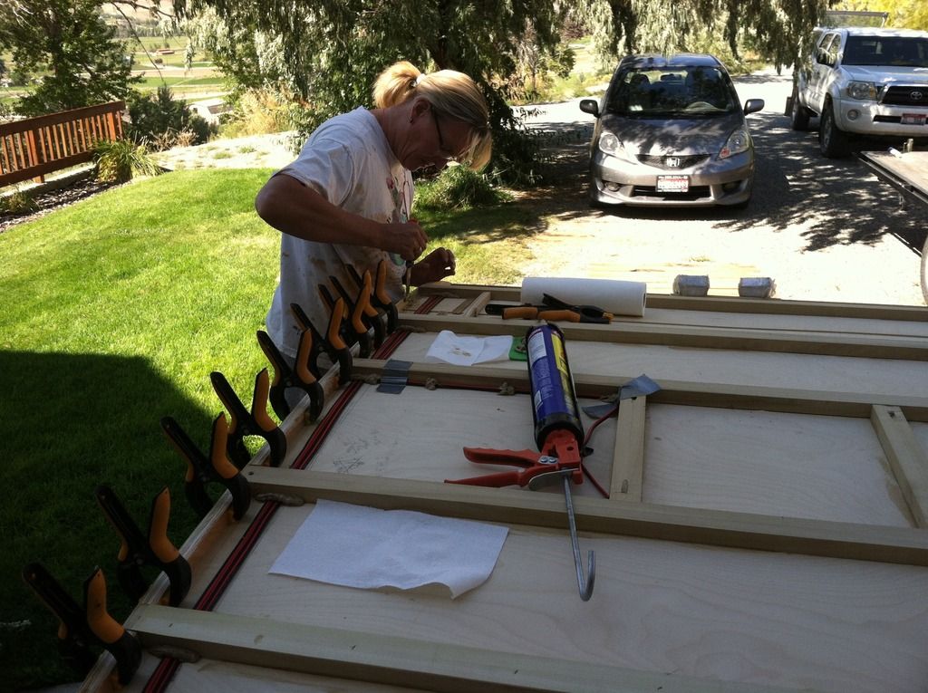

My ceiling/spar to wall arrangement is similar to the Fredricks method (ceiling and spars attacth on top of wall). Rather than trying to hold the ceiling up to the spars or use temporary supports to keep the ceiling from sagging while attempting to attach it to the walls, I positioned and glued the spars to the top of the ceiling panel before installing the ceiling. Sort of a cross between the Fredricks method and how Aggie/Tom did his premade roof assembly.
I used some small temporary alignment tabs double tapped to the top of the ceiling to help locate the spars and keep them from sliding around in the glue; and a 2x4 beam and wedge shim arrangement clamped to the work bench to be able to clamp the spars fully out in the field of the panel (or you could use weights). This allowed me to avoid having any visible fasteners in the ceiling.
