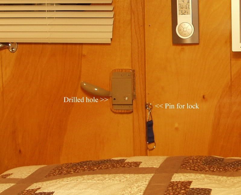

Postby 48Rob » Thu Mar 08, 2007 7:57 am
Hi Steve,
The strap is just to make it easy to hold the pin/remove the pin in the dark from the lock...a handle of sorts.
The pin is just slightly snug in the hole.
The hole is drilled through the front, and back of the steel case, and into the wood behind it by another 1/2".
Once inserted, the pin won't fall out.
Rob

Postby 48Rob » Fri Mar 09, 2007 2:27 pm
These pictures may explain it better than I can...
<img src="http://img.photobucket.com/albums/v284/1948rob/Cabin%20car%20project/pin.jpg?t=1173468070"><P>
<img src="http://img.photobucket.com/albums/v284/1948rob/Cabin%20car%20project/pin2.jpg?t=1173468235">
Anybody know what I made the pin out of?
(First hint is RR...)
