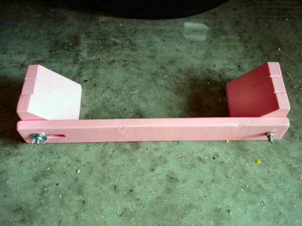

Why not use a piece of rope to hold them together?
Friction will hold the chocks in place against the tyre.
I've seen aircraft held in place this way. The rope was used to carry them, nothing else.

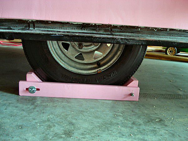

There is one camp ground that scares my wife. The sites are paved and drain toward the (Ohio) river. My wife is always concerned about rolling into the river at night (a little paranoid). These wheel chocks are a great idea, although I like to roll the teardrop in be hand and use the single chocks to stop it near it's final spot.
The dual chocks are a great idea that can be used to finalize the position of the tear.
Good job. :thumbsup:

I always carry a couple of 1.5 foot lengths of 2x6 to level the trailer, and 4 - 6 inch pieces of 2x3 with a chamfered long side. I always block both wheels.
After setting up, I grab the wheel and rock it back and forth pushing the chock against the wheel to get the chock block nice and tight under the wheel so it can't slip out... I have the h/f 1,800# trailer with stock wheels, so it is easy to grab the wheel.
Then I adjust the tongue jack to get every thing level. Everyone has their own system. I carry the blocks in one of those storage boxes along with extension cords, wheel lock, cable tv cables, etc. Puts it all in one place and makes it easy to carry around.

Sam, thank you for sharing your idea and for illustrating it so well. Here are the ones I made.

Imitation is the sincerest form of flattery they say! Thanks for using my design, Michele!
I have found a need for one small change to my design. I camped on some soft ground a few weeks ago, and with the tire sunk a little into the soil, the chocks sat a little higher on the tire, and would just barely fit! I need to lengthen the adjusting slot a little to make them fit easier.
