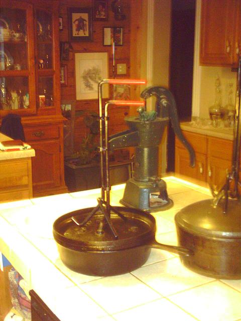

Postby bobhenry » Mon Mar 09, 2009 5:15 am
We have one of these in the kitchen as a conversation piece.
and yes it works but only if you prime it 1st
HUMMM ! maybe we don't need air or electricity after all.

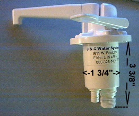

The reason I originally posted the question was to find out if it was possible to have the water storage tank as part of the pressurized system that was already there. Why have two systems? Why have two ways to get water in the trailer.
It seemed simpler to have, in essence, a huge water pipe (the tank) that would auto fill when pressured water was available. My thought was to mount the tank high and let it gravity take the water to the faucet when there was no pressure on the system. A single hookup outside the trailer, a single pipe, a single faucet for both pressured and non pressured systems, no pumps, and auto filling the storage tank. It seemed a simpler way. An air valve would be needed to let air in or out of the storage tank and be able to close when pressurized.
I have since stumbled onto to a $20 faucet that works as both a pressured and pump faucet. I intend to use store bought water from the container under the sink when pressured water is not provided.

Postby Frog » Mon Mar 09, 2009 4:02 pm
John:
Looks like the best of both worlds. Light and inexpensive. How does the water get pumped from the tank to the faucet? From the picture I couldn't tell if that handle on th right of the picture was a pump or a valve handle. What are you going to use for a tank, i.e. built in or portable?

Postby john » Mon Mar 09, 2009 4:39 pm
If the handle is pushed down the valve to the pressured water is opened. If the same handle is raised and lowered repeatedly water is pumped from a tank.
I have bounced back and forth on the water storage question. Right now I am partial to a container of store bought water under the sink. It has the advantage of good taste.
The idea of a 5 to 15 gal storage container is appealing, but I don't think it will be needed and the storage tank can get funky. If I change my mind later I can always add a permanent tank.
