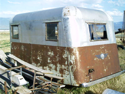

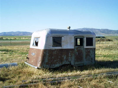

Hey Doug, I like the idea of a scaled down "Bread Loaf". I've been saving these for my next build.
My current build "Vintage Clone" is 5/6 scale of a 1953 Fleetwood trailer. I have 84" to work with at the garage door and ended up with a 5'4" x 22" door. Getting in is easy because the top is still over my 5'11" head. Getting out requires alittle memery not to hit my head. :?
For the radius on the roof of the "Bread Loaf", I have found that most are not a true radius. More like 9" up and 12" in. I have not done the scaled down math yet, but beleive I will end up with the same door.
