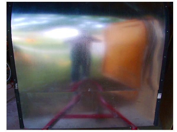

Postby Danny » Sun Aug 30, 2009 11:20 pm
8) I just put mine on thursday and got it all sealed up and trimmed out, Yeah I know pix..The sides are still woody and the trunk lid also. just the top and front are metal now looks great. Tin top woody!! :thumbsup:

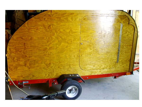

NEW PIX OF MY TEARDROP
Postby Danny » Fri Sep 04, 2009 5:01 pm
As promised :) I took some pix of my tear. They are now in my album...Danny

Postby starleen2 » Fri Sep 04, 2009 6:25 pm
OOOoooo - so shiny :thumbsup:

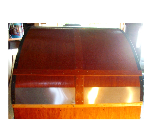

Postby Miriam C. » Fri Sep 04, 2009 8:13 pm
:applause: :thumbsup: :thumbsup: :woohoo: :beautiful:
You are almost done! So what is this black vinyl and how does it do on the curves? Does it shrink to fit?

Postby Danny » Fri Sep 04, 2009 10:15 pm
Miriam C. wrote::applause: :thumbsup: :thumbsup: :woohoo: :beautiful:
You can see them in the photo above. They are the same shape as the aluminum ones we are all used to except they are a composite material very bendy and easy to use. and 1 1/2" wide. They have screw holes every 8 "..They come in 6 1/2 foot lengths. 2 bucks per strip. they have an edge(lip) that goes over the sides. I will try to take a picture of a strip next time I have the camera outside :roll: Found them at a box store.

Postby Danny » Fri Sep 04, 2009 10:18 pm

Postby Danny » Fri Sep 04, 2009 10:21 pm
