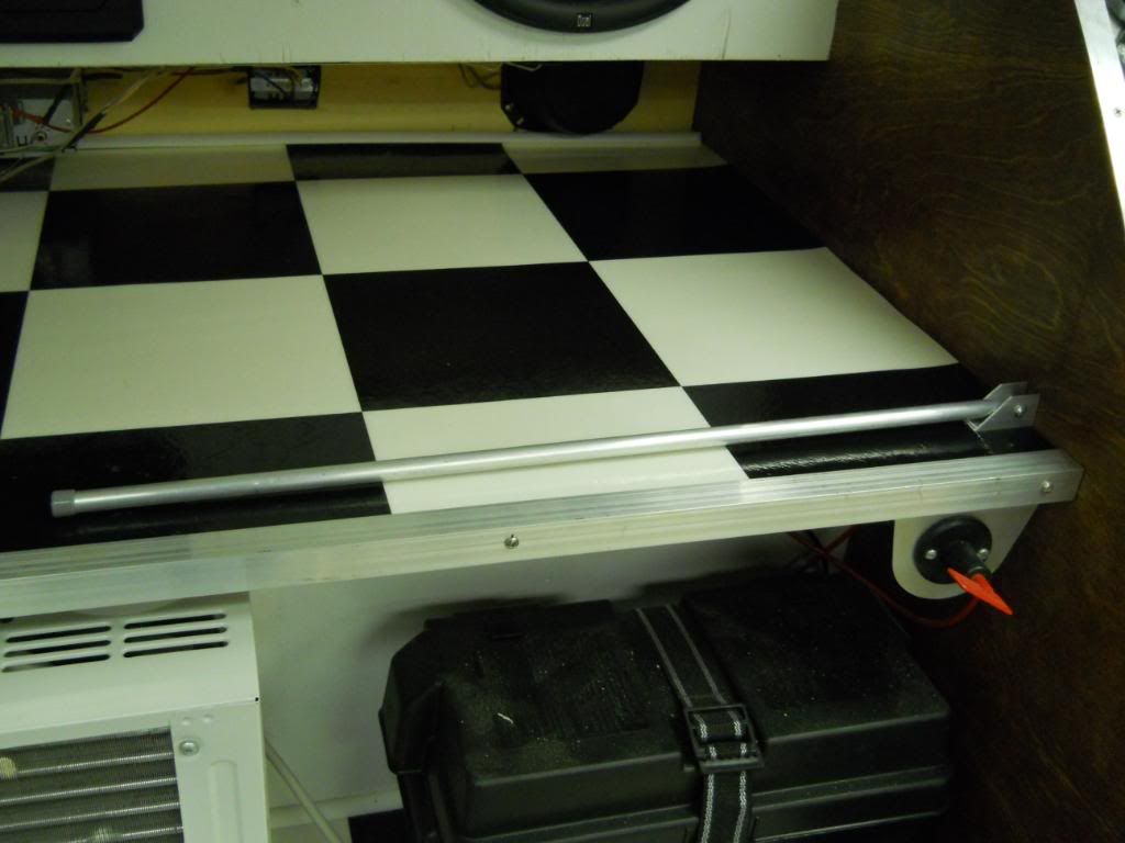

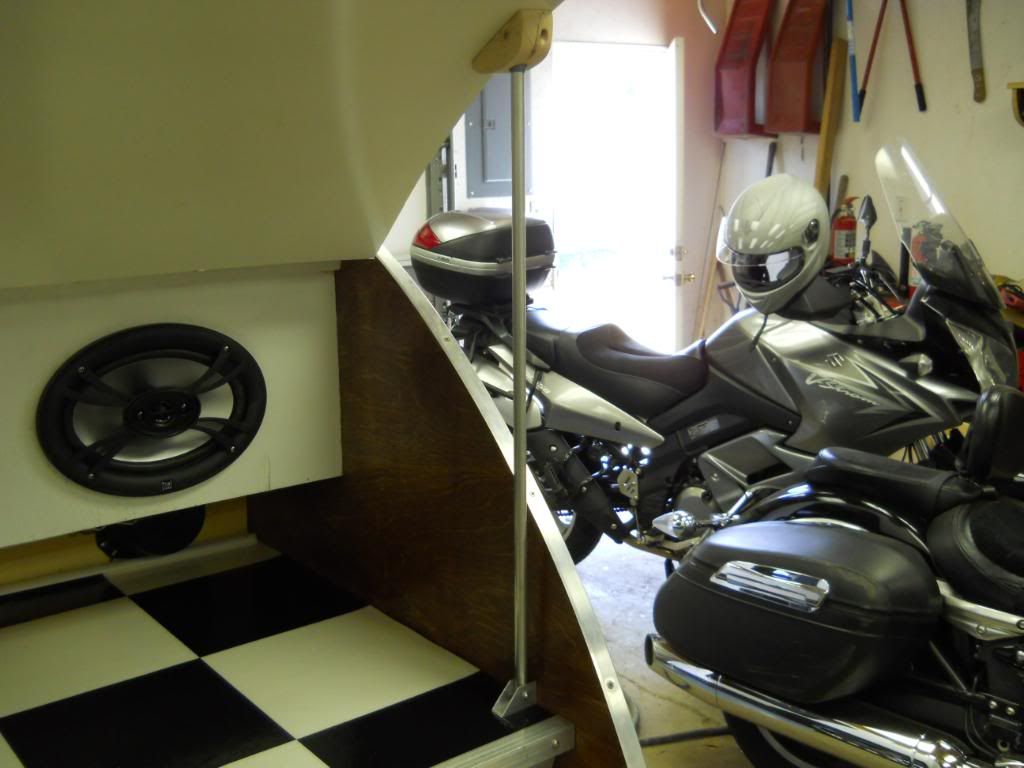

using a caster wheel with the wheel removed and a broom handle being thrown out at work, I plan on wood dowels in the future as I love wood, but the metal worked. I planned on a caster at the bottom end but will be using the folding doorstep idea instead. I would lower the hatch at night but needed to keep it open some for airflow to the air conditioner, thanks to the flexibility of the caster base I could pull the rods back slightly and set the bottom of the poles on the ground leaving a large enough gap at the bottom of the hatch, but protecting the galley from rain.
prop rods folded for travel 97092
the axle was a bolt, so it was easy to put the rod in instead of the wheel 97087

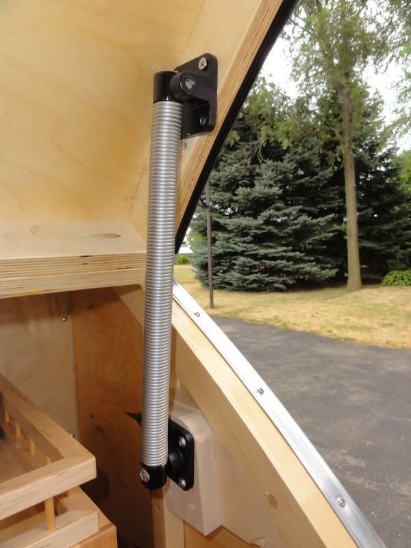

I use these marine springs. Similar to a pole prop but nothing moves. To close you just push them slightly and let the hatch down. Got them from Frank Bear.

Do those bend in when shut? I have seen those on his website but I didn't want the spring part swinging around scratching everything when in transit.

Just slip some vinyl tubing over them, or make a cloth cover.
