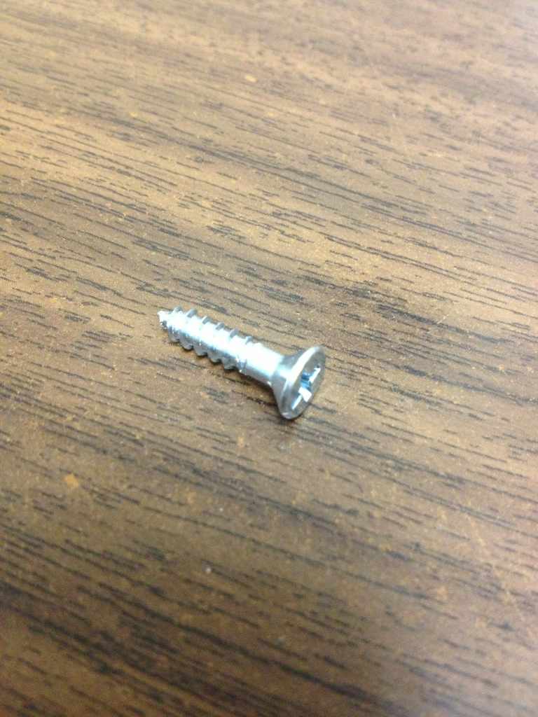

Postby tscarbroughdc » Thu Sep 19, 2013 11:49 am
So will this screw not work at all?

Postby RandyG » Thu Sep 19, 2013 1:26 pm
That screw is counter sunk, it may damage the plastic. If going with screws, as Kc said, use a screw that is flat on the back side of the head.

Postby len19070 » Thu Sep 19, 2013 2:22 pm
RandyG wrote:That screw is counter sunk, it may damage the plastic. If going with screws, as Kc said, use a screw that is flat on the back side of the head.
True, thats not the correct Screw to use. A Pan head would be better.
But!
As long as you put it in Diplomatically....and not use an impact gun or any kind of Power tool, it will work.

Postby tscarbroughdc » Thu Sep 19, 2013 3:04 pm
Awesome! Thanks for teaching me all of this! Haha. I know it may be common sense but I'm not a handyman AT ALL!

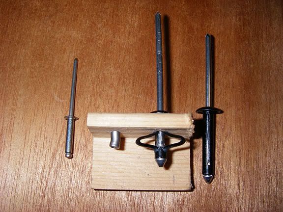

Postby rowerwet » Fri Sep 20, 2013 8:10 am
len19070 wrote:I'd use a Pop Rivet!
The one on the right.
Happy Trails
Len
these type of rivets are used to mount cleats on plastic kayaks, I just got some from west marine, they are also on ebay

Postby KCStudly » Fri Sep 20, 2013 9:52 am
West Marine Tri Grip Rivets $6.99 per 10 pack with what appears to be an o-ring gasket under the head.
Yak-Gear Tri Grip Rivets $5.74 per 10 pack, does not appear to include a gasket.
Thanks for the info. :thumbsup:
