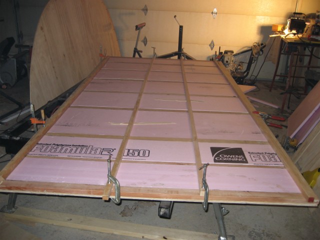

Postby let's went » Mon Sep 08, 2008 11:10 am
Like several of you have mentioned we built an insulated floor to better enable winter camping. It is a sandwich with xynole covered 1/8" ply, 3/4 foam and 1/4" ply top. I now wonder if the insulation was overkill. How do you all balance the need to stay warm with the need to keep vents and windows open for fresh air? It seems like these values are in conflict. Obviously, there are other means to stay warm. An extra blanket seems alot more simple and cheap than an insulated floor.
