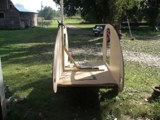

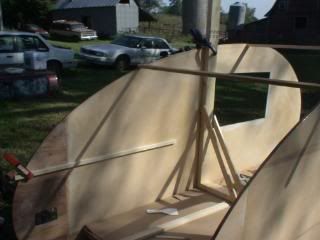

Postby Aaron Coffee » Fri Sep 18, 2009 4:31 pm

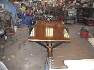

Update with pics
floor on frame
walls are up
I should have made the floor the length of the body, I think I will extend the floor on both ends.
The long cross piece repesents where the hatch will start and the longitudinal on the wall is approximately the height of the shelf.

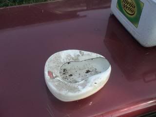

One last thing any ideas on how to incorporate this into my build(bought it unused at an auction for $1.
Thanks

Postby Aaron Coffee » Fri Sep 18, 2009 7:02 pm
trailer started out as a 40 wide x 48 long nu-way kit from Menards, I made new side rails and stretched it to 75 inchs long. Walls are 107 1/2 or so and 43 1/2 tall.
I downloaded the dxf from the design library for the cub. I was going to have one of the engineers at work resize it for me, got bored of waiting so I just played around with turbo cad until I got it close enough to the size I wanted, then played around and figured out how to get a point by point measurements and used those dimensions to draw it out on cardboard.

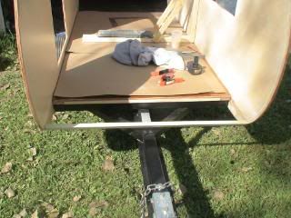

Postby Aaron Coffee » Sun Sep 20, 2009 7:41 pm

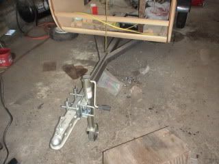

Yep, trailer has set since 2004, thanks for the reminder. Looks like I will need a new tongue as this one only extends about 18 inchs past the most forward part of the body.
Got the floor extension supports done. Just need to cut plywood yet and pull it apart and epoxy the new peices.
Here is the rear both of these where cut from 2x4 and will also act as spars.
Here is the front, the crossmember with the red X will also act as the first spar where the aluminum will start. I goofed when putting the walls up I put them level with the frame rails and forgot that the tongue is actually 1/8 higher than the side rails and wouldn't have been able to get the first spar in at the start of the current floor, and wouldn't have had room to get any screws in.Image
everything underneath will get three coats of epoxy.

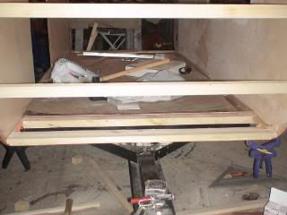

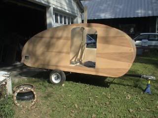

Postby Aaron Coffee » Tue Aug 23, 2011 8:37 pm
Two years and I'm still not done! Have made some progress.
Galley done.
Cabin Shelf
Wheel, tires and fenders mocked up
Tongue lengthened. Still need to have braces welded.

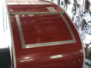

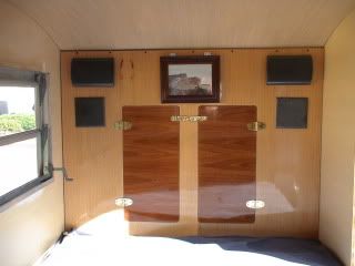

Postby Aaron Coffee » Sun Sep 11, 2011 2:37 pm
Here are updated pics and looking for opinions.
Opinions wanted: White insert trim, leave it or sand/strip it down to mill finish?
Fenders? Red to match body or black or some other color?
Any ideas on a galley hatch? Bought some lockable latchs at menards and they won't work. Kind of thinking of model A hood latchs but then don't have lockable option.
any other thought, ideas, comments, etc.

Postby parnold » Sun Sep 11, 2011 10:02 pm
I don't see the bedpan in your last batch of pictures. I was thinking you'd turn it into a sink.
:lol:
Very nice looking trailer.
