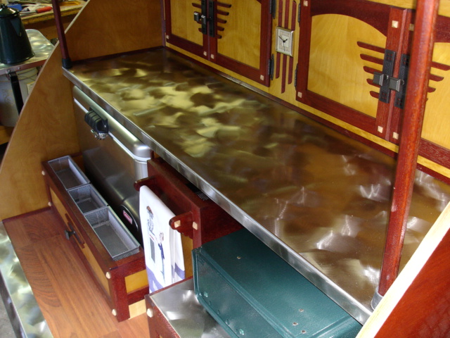

Not sheet metal, but I've done stainless in 2. Only had it sheared and 1 90 degree bend on them, rests on a ply sub base. I did a scuff treatment with a DA sander on it...Doug

Postby doug hodder » Sun Mar 14, 2010 10:33 pm
I would imagine fairly thin...don't think I'd go below 3/8 though. The top gets all it's strength from the 90. The ply gives support between the walls at that end. Doug

Postby Lou Park » Fri Oct 15, 2010 7:09 pm
doug hodder wrote:Not sheet metal, but I've done stainless in 2. Only had it sheared and 1 90 degree bend on them, rests on a ply sub base. I did a scuff treatment with a DA sander on it...Doug
Now that, I like.
