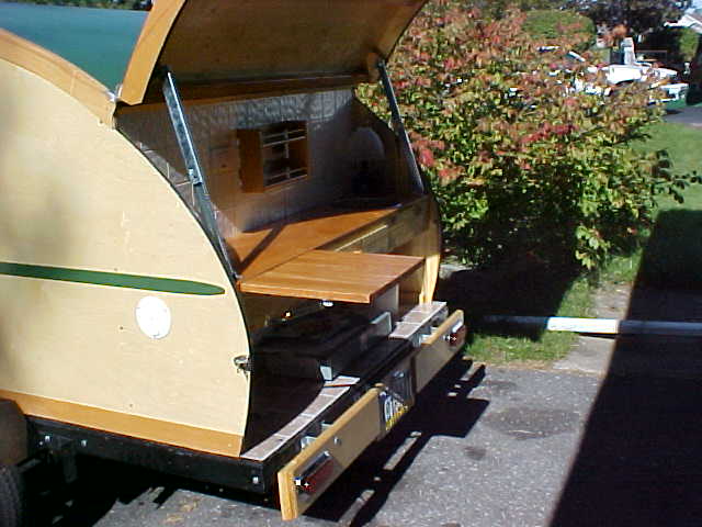

I went a simpler way on my hatch. I built the rear of the teardrop with spars and skin as if there wasn't going to be a hatch, then cut the hatch free after it was skinned. The advantages: no curved ribs to make, and only two curved jigsaw cuts to make. It's light, simple, and has zero spring back with 1/8" Baltic birch skin. The birch literally falls around the curve, and produces no forces trying to make it spring back. I added a second layer of 1/8" skin on the teardrop and the hatch for more strength. There are more photos in my Flickr album.

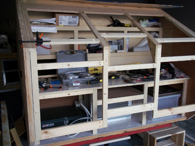

Toytaco2 wrote:Well, yes, I did insulate my hatch and finally found a pic to prove it. Seems to me if the rest of the build is insulated, then the hatch ought to be insulated also.
Hey Double-T2, are you building that thing in your living room???
:lol: :lol: :lol: :lol: :lol: :lol:

Sam I am wrote:I went a simpler way on my hatch. I built the rear of the teardrop with spars and skin as if there wasn't going to be a hatch, then cut the hatch free after it was skinned. The advantages: no curved ribs to make, and only two curved jigsaw cuts to make. It's light, simple, and has zero spring back with 1/8" Baltic birch skin. The birch literally falls around the curve, and produces no forces trying to make it spring back. I added a second layer of 1/8" skin on the teardrop and the hatch for more strength. There are more photos in my Flickr album.
That's a really interesting method. I just don't trust my skill with a jigsaw to make the two cuts along the side. How did you seal the hatch to prevent water leaking into the galley?

"How did you seal the hatch to prevent water leaking into the galley?"
Lil, I used foam tape (one side sticky) on the edge of the teardrop sides where I had cut the hatch free, and on the front edge. You can see the black edge of the tape in the photo. The tape gets compressed when the hatch is closed and the draw latches on the sides are engaged. I've taken it through major downpours with no leaks!
