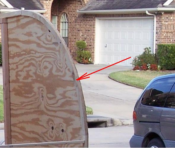

Postby mikeschn » Mon Jun 18, 2007 5:32 pm
Steve,
For the weekender standy I am going to suggest the construction style you used. You used 1/4" plywood, right, backed up with 3/4" studs? I am going to suggest moisture resistant luan backed up with 3/4" studs.

Postby mikeschn » Mon Jun 18, 2007 6:41 pm
How did you form your curve?

Postby mikeschn » Mon Jun 18, 2007 6:48 pm
No no no.. I mean the 1x2s that you have following your curve...
P.S. Looking closer, it looks like you cut a couple plywood ribs to match...

Postby mikeschn » Mon Jun 18, 2007 7:26 pm
That's why we talk in pictures...
Here's what I am asking. How did you cut this rib... It's 1/32" thinner than all your pine ribs, right?
Postby steve wolverton » Mon Jun 18, 2007 7:35 pm
mikeschn wrote:That's why we talk in pictures...
That's one of the 3/4" plywood curvy parts that I was talking about. :D Yes, it's a little thinner than the 1x2's.
