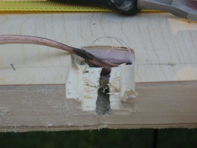

Well I got so caught up in putting on my outside first layer roof I did not pay attention to my buried wires. I figured I better check the wires before I closed up the roof with the final skin. I ran 110 through the wires and sure enough I stapled right into my roof vent wire. It made a nice pop, as you can see from the burnt wire. So I had to tear into my new roof and fix it. I put a wood patch over my repair and will sand it in the morning when I put on the final skin. At least I can cover my dumb mistake and only you guys will know.

I did pull the staple out and it worked fine then. But I separated the wires and taped up each side. The sad part was I was looking right at the wire sticking out as I went over it with the staple gun. I managed to miss all the other buried wires. I only have a few spots where I run through the roof ribs. I guess I can only do one thing at a time.
