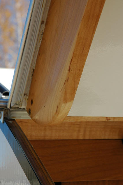

My hatch ribs go inside the galley walls by about 1/4" on each side. Then it was skinned with my Luan, Filon and then a aluminim trim that overhangs the walls by a 1/4". I applied my seal/weatherstrip to this overhang on my hatch.
I also beveled the hatch rib at the top to "Ramp" it into the galley walls if the hatch would get off center.
