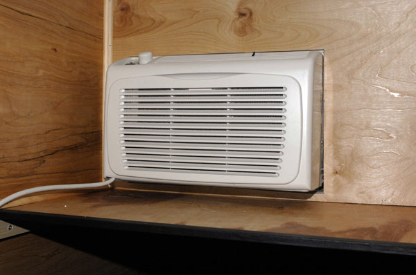

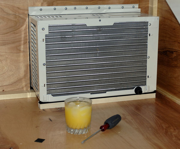

Postby caseydog » Thu Mar 22, 2007 1:38 pm
Well, I dove in and got it installed between the galley and the sleeping area. I just need to do some caulk and trim work to cover the gaps, and run a drain hose for condensation.
Here it is from the galley side, with two of the screwdrivers used during the installation. :lol:
And here is the inside view -- trim needed for those gaps.

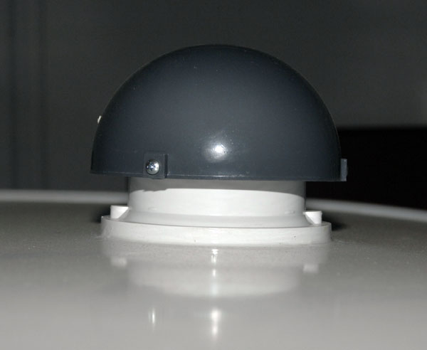

I need to put a vent in the side of the TD for intacke of air to cool the AC workings, and I will probably put one of my fancy Mushroom Vents (plumbing vent cap and pipe) above the unit for hot air to escape.

Postby Dooner » Thu Mar 22, 2007 8:21 pm
Hey Caseydog,
You will need alot more vent to get that hot air out of there. You will need close to the same size as the coil at the back of the unit. There is an old thread that explains that. I'll search and post.

Caseydog... Yeah, I agree with Dooner. You will not be able to dump all that heat into the galley area without a pretty good sized vent... or just cracking open the hatch, like I mentioned before. Of course, you could just run it like it is with the hatch open. John's vents from the bottom look interesting... Looks like a good idea to me.

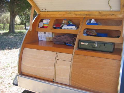

Postby caseydog » Sat Mar 24, 2007 2:12 pm
Well, what if I force the air through the small vent with a vent fan? That should have a similar effect to a largervent, wouldn't it?
The way a Little Guy is made, the bottom vent idea wouldn't be practical.
I don't want a huge vent on my galley hatch, if I can help it.
leaving the galley open a bit, or all the way, is okay in some circumstances, but not in others.
I'm hoping a small vent with a fan will work. What do you think?
