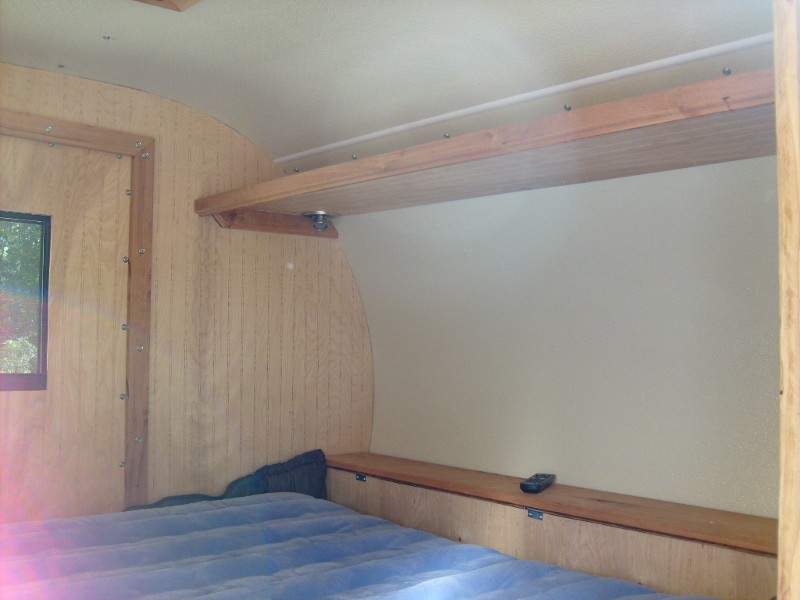

Good idea or bad? :thinking:
I'm needing to get a little more interior storage space in my design. I don't have room for a lower cabinet at the front, but was thinking about an upper cabinet or shelf above the pillows.
Thanks for your thoughts.

Not a bad Idea. :thinking: Just don't forget it's there when you wake up in thte morning! ;) :D :D

We have the upper front cabinet its great for all the small stuff. Look in my album.

I have an upper cab. above my pillows but it is small. It could have been larger but the shape of my trailer (profile) cut into potential cab. space. A benroy profile helps with space.
I used the cab space above the pillows for a couple of fluorescent lights. They shine on the ceiling and set it to a glow. This eliminates the glare of a direct light in the eyes.
It also helps me sit up with a hand hold.

I made a small one that holds some stuff. Like wallets, flashlights keys etc. Wider corners for the lights.

wouldnt work in our Kit style. We would hit our heads and Kenny and I sit up to watch movies. I hung a fishnet across the back in front of the cupboards to hold simple things like flip flops and hats.

Just make sure you don't bump your head, it's a complaint I have heard from others. I built mine into the front curve of mine, although your design isn't the same as mine.

Thanks for they replies. :applause: I'll probably go with a shallow shelf placed high up for eyeglasses, wallet, keys, etc.

If your tear isn't built yet, lay on the floor in the corner of a room.
Have someone mark the arc your head makes as you "get up" from a sleeping position.
That will quickly show you how much projection your shelf or cabinet can have before causing a headache.

We have a headboard and an overhead shelf, thinking of putting another shelf in between.
