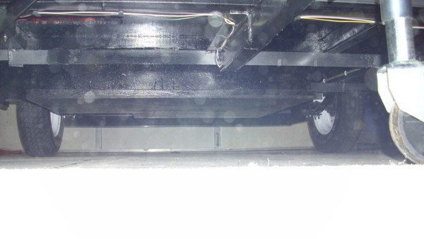

Postby shopfabricator » Fri Jan 23, 2009 10:35 pm
8&1/2"
Guess I need to clean the lens.
How did the midnight b-ball game turn out?
