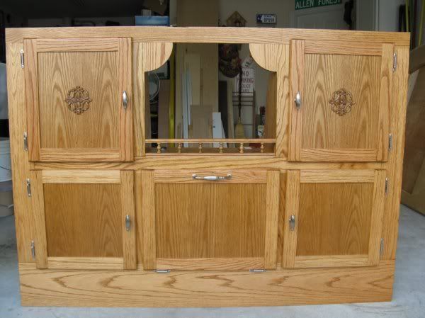

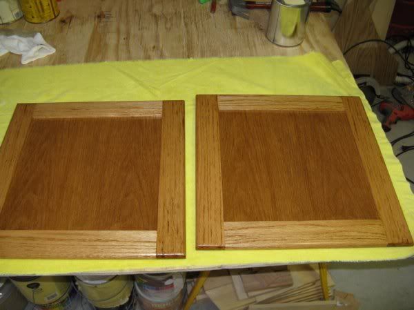

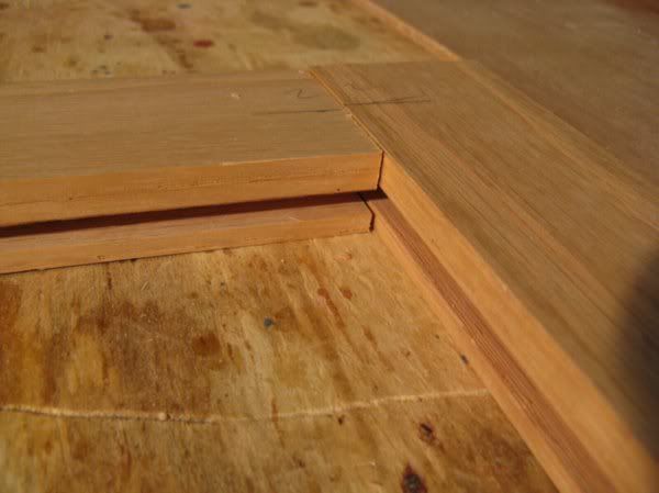

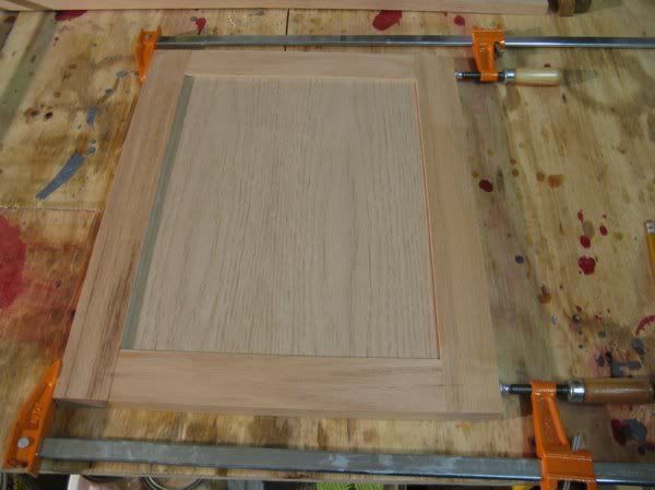

Postby planovet » Wed Feb 18, 2009 4:14 pm
I like Danny's raised panel doors but I didn't have the bits to do that. My doors are flat panel doors. They are built to be surface mounted rather than flush. Flush does look better but my way is a bit more forgiving of mistakes. I had never built any cabinets before so if I can do it, so can you.
The frames are 3/4"x2" Red Oak and the panel is 1/4" Red Oak ply. I cut a groove into the frames for the panel with a router leaving a 1/4" reveal on the front. I then glued it together with biscuits letting the panel "float". I rounded over the edges with a router and stained and urethaned them before mounting. Like I said, I'm a novice so I know you can do it.
