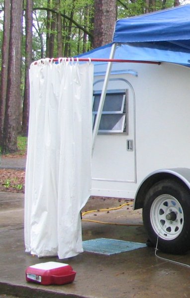

Postby Gage » Fri Mar 12, 2010 9:15 pm
Several have done that, but I think it looks tacky. This is what I did. Very simple. :thumbsup:

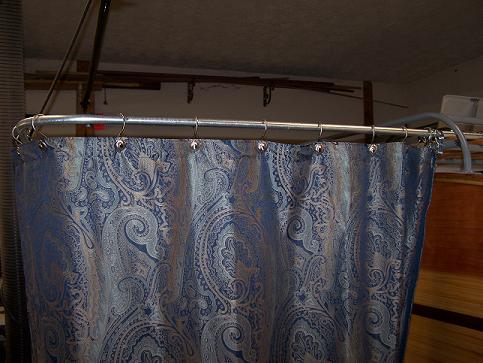

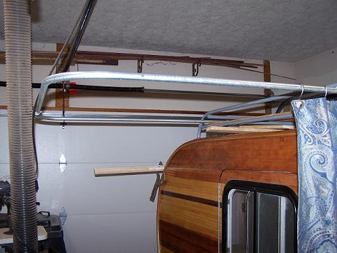

Mine telescopes out thru the side !
but you gotta be careful where ( hit deadon a roof spar even though I measured twice ) OOPS
My curtain don't look tacky does it Gage ? well at least I love it ! I did choose to use the outer dress panel of a shower curtain rather than the inner water proof vinyl inner panel. They are dressier and come in a multitude of prints. I did one thing right in that I hemmed the BOTTOM of the curtain to slide on the rod this leaves the button holes that were for the curtain rings available as a place to fasten a weight at the bottom of your privacy curtain.
Here is a good argument for weights and maybe some
snaps to the sides. Wouldn't be quite as nervous about using the
porta potty on a windy day :o
The 1 1/4 schedule 80 is tough and plenty stout and slides snugly into the 2 " schedule 40 pvc. I left one joint unglued as a place to break the horseshoe shaped rod and to slip on the curtain, it also provides storage for the roof spars. I cut sections of the 2" pvc into rings and removed a section so it will snap over curtain and added a joining nut by drilling a hole and installing a short bolt. This deep nut provides a pocket for a 1/4 fiberlass survey rod that was cut to make a hoop to support a roof

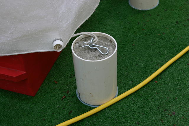

Cuyera's post of this weight .......
set me to thinking how could you restrict the wind movement of the curtain without carrying a ton of weights with you.
Here is a few ideas.......
The best idea on the old post was the Gripper snap mounted to the trailer side and its mate attached to the curtain to hold it tight to the side of the trailer.
How about those old pantyhose ... cut off the leg at about the knee and fill with rocks or sand from the sight and pull nylon thru gromet and tie a knot or cord it closed and thread thru button hole.
How about the old mans socks just sew the hole in the toe shut and the same drill ~ add a few rocks or a bit of sand and cord it closed. and tie to the curtain.
a little fancier how about a few " rock bags " ~~sew up some fabric into the size of a small draw string close purse and place a grapefruit sized rock in it and pull the draw string closed and fasten or tie them to the bottom hem of the curtain.
Return the sand rocks or soil to it's origin and toss your curtain weight containers in a small tote bage with the curtain. Now you are not hauling the weight just the container. :thumbsup:

Gage did you make your tent poles ? or are they store bought
and I have seen others with a similar set up how do you attach to the body of the tear ? Thanks Dan
