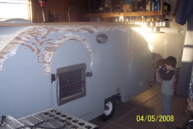

Postby starleen2 » Mon Mar 22, 2010 10:29 am
I used regular enamel house paint - read the key word "enamel". I also use 5mm luan for both the inside and the outside.
Hummmmm - it seems that they build boats out of fiberglass and use polyester resin for the bonding and gel coat - they built corvettes using resin - you'd think that if epoxy was that superior they'd be using it instead. There are plenty of boats and Kayaks built years before and after epoxy that are still in the water :thinking:

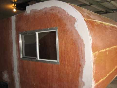

Postby Jst83 » Mon Mar 22, 2010 11:30 am
synaps3, how are you planning on finishing you camper? Mines 6'6"x11'6" so i understand what you mean by taking a lot to finish. All I did on mine was seal the seams and edges with the poly and tape then painted it with a good oil exterior primmer followed up by a couple coats of good exterior latex. I've had no problems in 2 summers. Gonna repaint this summer just cause I wanna different color :lol:
Mine does live indoors when I'm not camping so these results may vary if stored outside.

Postby Jst83 » Mon Mar 22, 2010 3:36 pm
synaps3 wrote:Voids and cracks will get filled with bondo.
Careful of the auto bondo I filled my seams with it then after a 16 hr trip and back it started to crack real bad I had to strip all me seams and redo them. might not have cracked so bad if I'd have put resin and tape over the bondo. Just ones mans issue with bonbo

Postby starleen2 » Mon Mar 22, 2010 3:48 pm
Like Scott said on the seams - fiberglass resin and fiberglass tape on the SEAMS first! then sand and Cover with Bondo to make for a sharp edge or smooth transition
