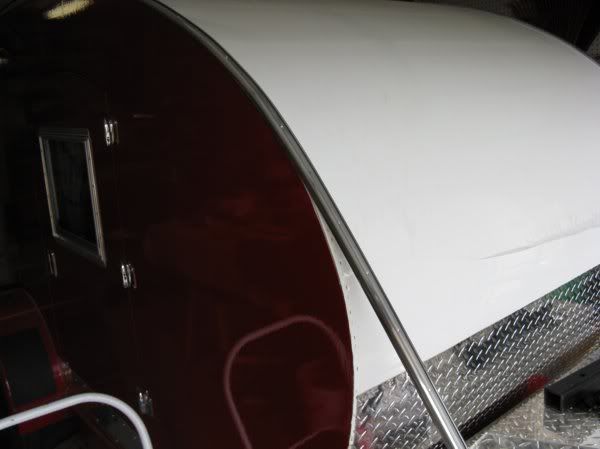

Postby ubear7 » Wed Jun 16, 2010 2:31 pm
planovet wrote:
Tackett wrote:What do you use for corner trim (where the top meets the side panel)? The pieces I have are L shaped, with the long leg going on the top, and the short leg on the side.
Not sure what MJ used but I used a insert molding that you can get at most RV stores. Comes in mill finish and white mostly. You can find inserts in many colors.
Is the molding pictured easily worked around the curves with ease and without crimping, or is annealing needed? I like this option, it leaves a very clean look. :applause:
1998 Dodge Ram 3500 4x4, 2006 Dutchmen Denali 33rlbs
ubear7
Posts: 19
Joined: Tue Feb 09, 2010 5:30 pm
Location: Miami, FL
Postby planovet » Wed Jun 16, 2010 2:59 pm
ubear7 wrote:Is the molding pictured easily worked around the curves with ease and without crimping, or is annealing needed? I like this option, it leaves a very clean look.
It took my curves with no problems, no annealing needed. I just took my time and eased it over slowly.
The lip may bow out a bit on the sharper curves but it was easily tapped back into place with a rubber mallet and a gentle hand.
