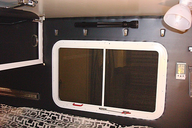

Check my thread, I have a 48" window in my little 4X8. I screwed from the outside and used butyl tape to seal, then also siliconed it. No leaks, and provides a great cross draft! Mine is mounted so the bottom is just inches above the surface of my mattress, when my ceiling fan is on it draws a nice breeze across most of my body.
You can see it in my signature pic below.

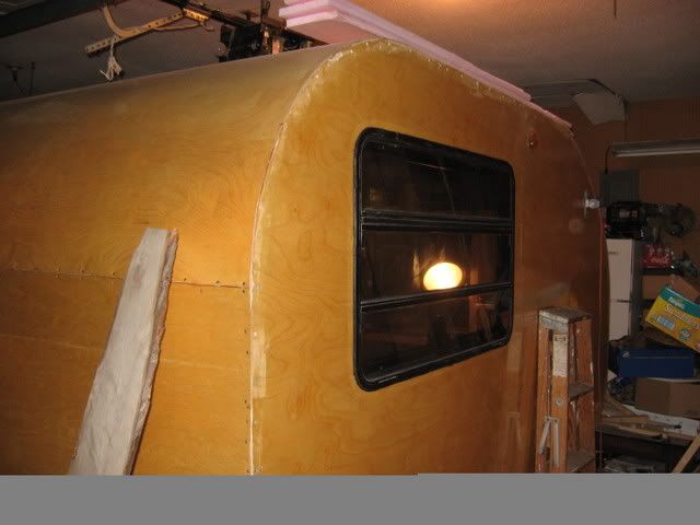

We have a large window in ours as well.
We opted for a large egress window instead of a second door.
Our window is hinged at the top, the entire window swings out when open.
It provides nice air circulation.
We screwed ours in place from the outside. I have used butyl tape and sealant on previous builds. I prefer sealant.
