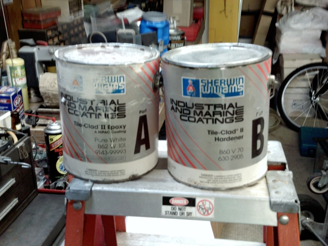

Postby SkipperSue » Sun Nov 07, 2010 12:28 pm
I used a 2 part epoxy paint on mine. This paint is super tough. I had a guy looking at my trailer down at Hunting Island state park and he thought that it was a laminate material. I used Sherwin Williams Industrial and Marine finish. You mix equal parts and paint it on. You have about 2 hours before it sets up.
Skipper

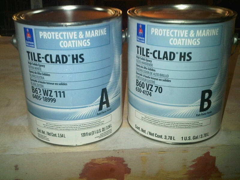

Postby Riken » Tue May 03, 2011 5:24 pm
After numerous searches and trying to decide on an exterior finish. I liked how SkipperSue's unit looked like. I also was interested in the super tough part as well as the not look like wood part. My wife wasnt crazy about the camper looking homebuilt so I decided to look into the Sherwin Williams Tile Clad HS. I contacted my local Sherwin William Industrial store and he said this is stocked at most Sherwin Williams Retail stores. In fact my local store has 16 gallons of A and B on the shelf. It is a lil pricey (140 bux total) and can mixed in any color (although I stayed with White). According to the data sheet this is some good stuff and durable. I am hoping to paint this weekend. I have laid down 3 coats of the GPW waterproof mix and will apply at least 2 coats with Glidden Gripper and then 2 coats of this epoxy paint. Don't know if I need to apply clear coat since it says Gloss Hardener but will see what happens. I will post pics after paint. Got a camp date weekend May 13 so I gotta hurry!
Build #2 is much better than build #1. I just followed Mike signature line on this one
maybe this will work?

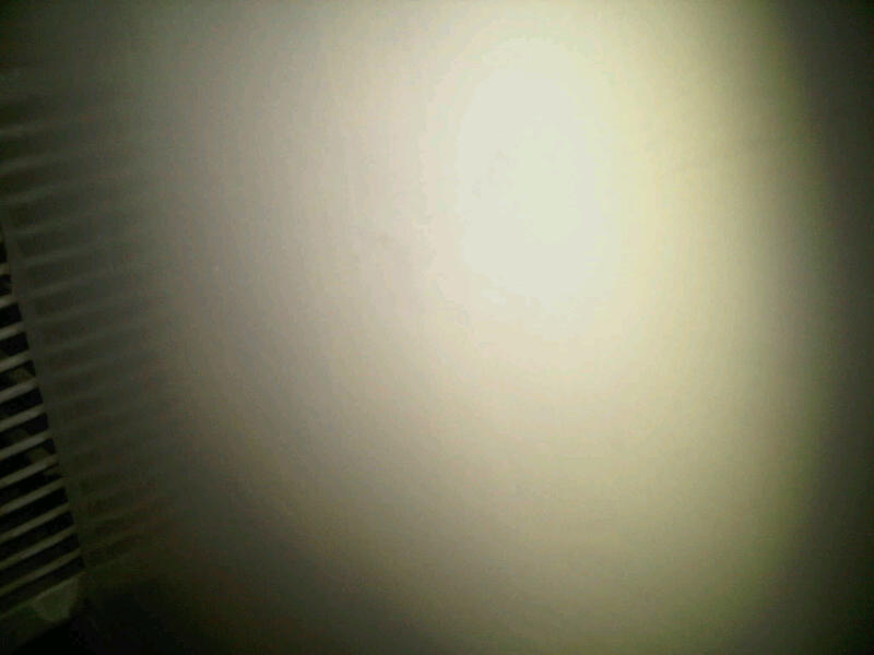

Postby Riken » Thu May 19, 2011 12:30 am
this paint is thick and syrupy and strong but wow . This is the first coat over my primed surface. you can see the REFLECTION of the ac in it. this was after its dry. this paint is sticky immediately after applied and dries to touch before you know it
as far as the UV protection I would say were Good
Here is the link to sherwin williams and the data pages

Postby Riken » Fri May 20, 2011 12:15 am
yeah i got the feeling that customer service is not the highest on sherwin williams list.
If you download and open the data sheet there are some ASTM tests results. Says exterior durability 1 year at 45 degree south - says Excellent chalks? I am not sure what that means but I am sure someone on the forum can decipher the data sheet. This stuff is seems pretty tuff. I have no choice but to roll with it and I believe it will hold up fine, Just my initial coat and it is very durable, Going to start second coat tomorrow
I have the part A in white and the part B gloss hardener
