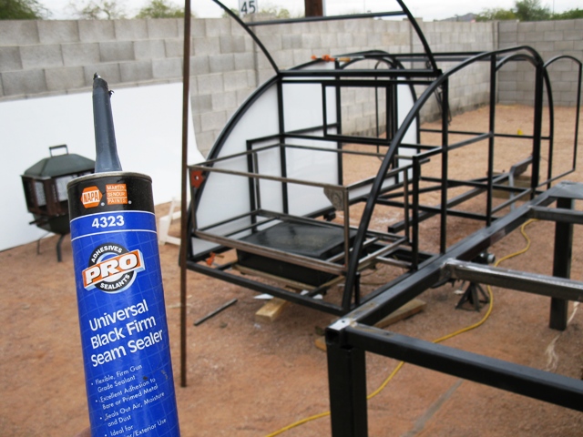

Postby emiller » Wed Jun 29, 2011 8:37 pm
I used this
