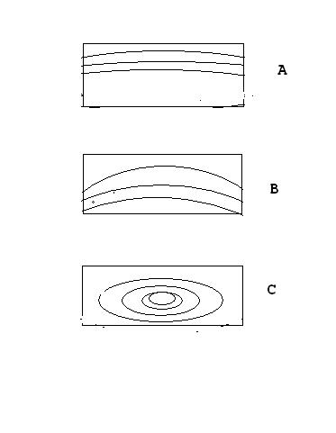

After building several hundred mini barns I finally learned to read the end grain of the lumber I was selecting for my trim boards and selected each board myself.(Drives the lumberyard help crazy but OH WELL).
As you look at the grain ....
A ~ is what you really want to see near flat horizontal parallel lines. This is as close to quarter sawn as you will find in todays market except in expensive hardwood blanks.
B ~ will with moisture turn into a horse shoe across the width of the board.
C ~ was cut from so small a tree it still thinks it's a tree, and will do all kinda of strange things. You have grain working against grain and is very likely to twist as well as bow along its length.
If you learn to read the lumber you can pick and choose the better boards when needed.
As to storage "flat on floor" is not a great idea unless you place uniform sized "stickers" every couple of feet to avoid wicking moisture from the floor (especially concrete). Cube them as deep as possible and a little weight is a good idea if it will be several weeks of storage.
