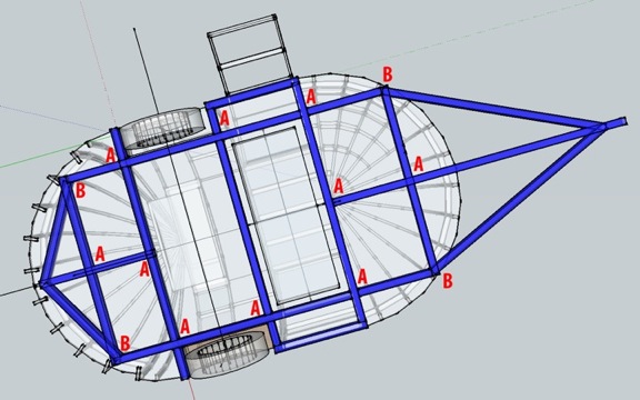

Working closely with the generous support of eamarquardt, I've come up with this chassis design. Since my design is non-traditional, I think it requires a somewhat non-traditional frame. At points marked "A", there is a half-lap joint, at points marked "B", there is a chunk cut out and a bend in the frame piece with a crosspiece inserted. This design seems strong and doesn't have the dropped V leading to the hitch, which leaves a big part of the floor unsupported. A real-life specimen is here: http://www.tnttt.com/gallery/image_page.php?album_id=1588&image_id=34299
I'm not satisfied with the back end yet. The "B" points may be too radical a bend, but Gus keeps spanking me for putting butt joints there. There are still some unsupported parts, could angle iron be put in place there and nipped and bent to conform to the curve? I think that would keep the weight down. I'm thinking that the floor will be two sheets of 1/4" plywood with 1/2" of styrofoam in between with plywood or pine sandwiched in the edges so the foam isn't exposed on the outside. The whole thing will be wrapped in aluminum, with 1/8" baltic birch under that.

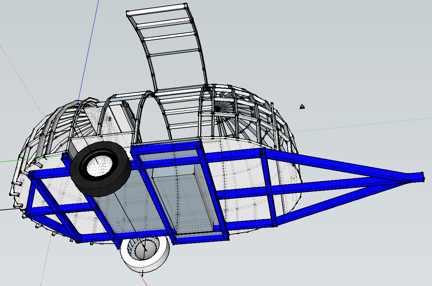

Here's a side view. I'm still learning to use SketchUp, and making it show the actual bends and laps is way more labor intensive than its worth.
Picture 1.png (102.59 KiB) Viewed 512 times
Whaddaya think?

Pretty nice looking lay out :thumbsup: .
At your "B" points I'd go with mitered butt joints, welded all around, ground flush to accept a sistered/welded gusset on the underside to give additional strength.
Any way that's how I do my chassis.
I also weld a 3/16" plate across where both side pieces meet the draw bar, top and bottom, after initial welding, as mentioned above.
Just my opinion. ;)

Yeah, those front B points are critical and making a good joint between the A-frame and the main rails is all that matters - the cross member is secondary. So get the long joints fitting right and 100% welded before trying to fit the cross-member in.
At the back I'd leave out the last cross-member altogether as it isn't doing anything that the two angled cross-members (the 'rear A-frame', so to speak) can't do. I presume you want a rear receiver - if not, I'd drop the rear centreline piece too.

+1 what Angib and Danny said.
As far as pie cutting and welding angle to form the rear curve, you would be better off following Angib’s suggestion to eliminate extra steel, and then reduce the ply thickness on your floor (maybe use 1/8 inch or 5mm, at least on the bottom), but go thicker on the foam and wooden sub frame. The further apart you put the stressed skin panels the more rigid the floor and the more capable it will be to suitably cantilever out past the steel without additional support. The amount of cantilever that you are depicting appears to be modest. At the front it is probably not as big an issue because you will not likely have big point loads right at the edge, but in the back where it is easily conceivable that you could be dragging a fully loaded cooler off the edge, stepping up or sitting on the edge it would be more important (assuming that your rounded rear opens like a traditional hatch).
If it were me, I would go at least 1 inch thk on the foam core, if not 1-1/2 (in fact, I will be using 1-1/2 thk foam with 5 mm ply top and bottom, and I have no cantilever to my floor at all, but am using relatively light angle intermediate xmbrs in my frame and don't want any sag under my 240+ lb. butt). Perhaps others can advise on the amount of cantilever vs. stressed panel height that has worked in the past.

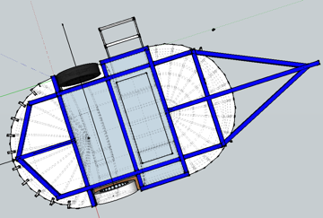

Postby StanDahl » Mon Apr 09, 2012 4:22 pm
Okay, how's this?
Picture 2 sm.png (80.66 KiB) Viewed 470 times
I like the idea of trimming that last crosspiece, it seemed like there was just too much in there somewhere, but I couldn't put my finger on where. I will keep the centerpiece in the rear, it would be nice to be able to put a bike rack in there.
I would like to support the floor edges better, especially on the galley section where there could be some force (mis)applied at some point. As for 1/8" ply on the bottom, I know it's done, but it just seems sooo thin. It would have thicker wood on the edges, and I suppose over the chassis bars, so... maybe I should just trust you guys and go with it. :thinking:
John
StanDahl

If you are worried about the outer radius. You take your radius measurement to a metal shop and have them bend a pice of angle or square tubing to fit. Just another option. But like everyone else it will work the way it is.
