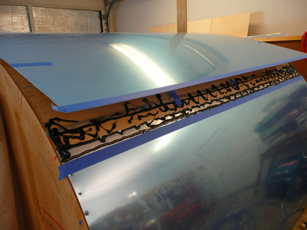

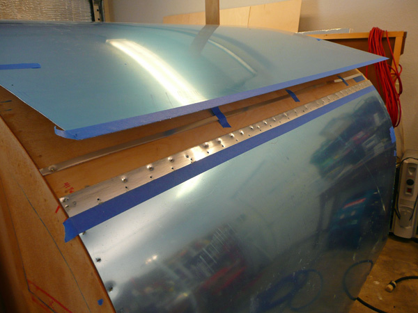

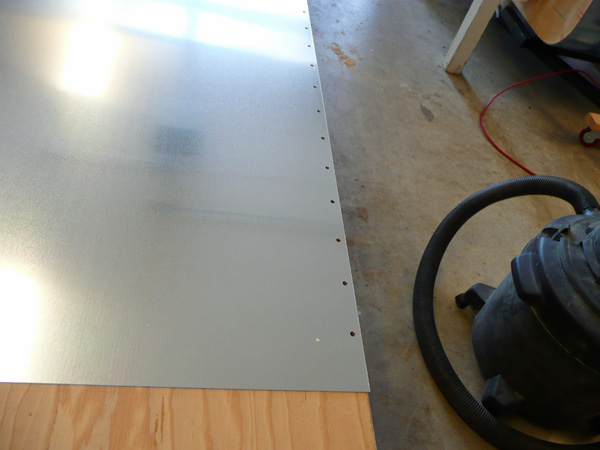

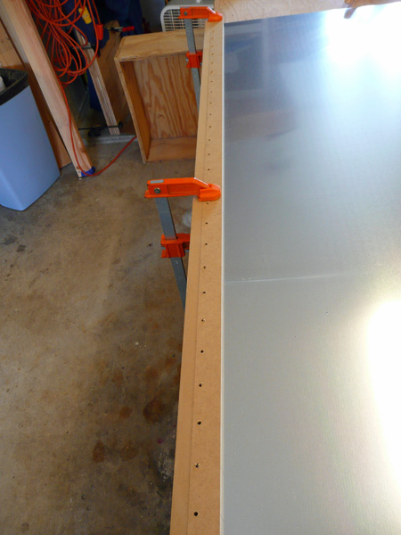

With a 5-foot wide teardrop and 4' x 10' aluminum I had three transverse seams - two on the teardrop and one on the hatch.
At the seams, I overlapped the aluminum. I first installed the bottom layer. Then, on the top layer, I pre-drilled holes for screws that would fasten through the two sheets into the spar. I used a drilling jig made of scrap MDF as a guide for spacing the holes. Then I temporarily fitted the top sheet and drilled holes throught the bottom sheet and into the spares. I peeled back the top layer and added sealant at the overlap of the seams. Then I placed the top sheet back into position and installed temporary screws until the sealant had set. Then I removed the temporary screws, injected sealant into each pilot hole, and installed permanent stainless steel screws.
Here are few pics of the process:
This is a pic of the hurricane hinge getting ready to be installed, but it shows the method and type of syringe I used to inject the sealant into the screw holes.
This is the best picture of the finished seam that I have. Please note that in the picture below, I had not removed the sealant "squeeze out" that happened when I installed the permanent stainless steel screws.

Postby inthewoods » Thu Oct 17, 2013 1:44 pm
@Tom. Thanks for the nice photos and details of your build. How much of that 3m sealant /adhesive did you use? I will like use sikaflex 221 which seems to be similar but easy for me to get locally. I just have no idea how much I'd probably need.

Postby aggie79 » Fri Oct 18, 2013 11:28 am
inthewoods wrote:@Tom. Thanks for the nice photos and details of your build. How much of that 3m sealant /adhesive did you use? I will like use sikaflex 221 which seems to be similar but easy for me to get locally. I just have no idea how much I'd probably need.
Sikaflex 221 is a great product and will work fine. I used a bunch of sealant and probably too much. I'm pretty sure Sikaflex will have a brochure that will give you an estimate of linear feet of sealant per tube for a certain bead size.
I believe the 221 is a moisture-cure product like the 3M 4200. If so, make sure you have enough work ready to seal when you open a tube because you probably will not be able to save any remainder for application at a later date.
